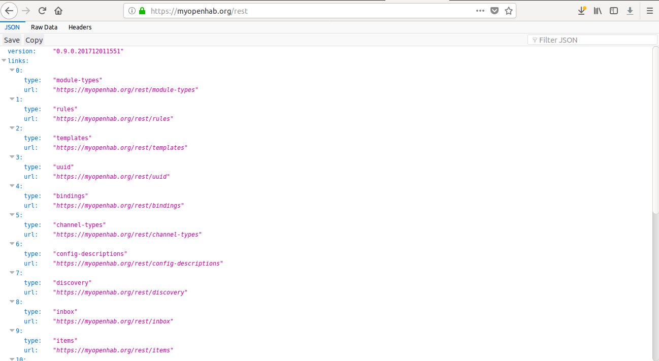

Sample screenshot of myopenhab.org/rest.

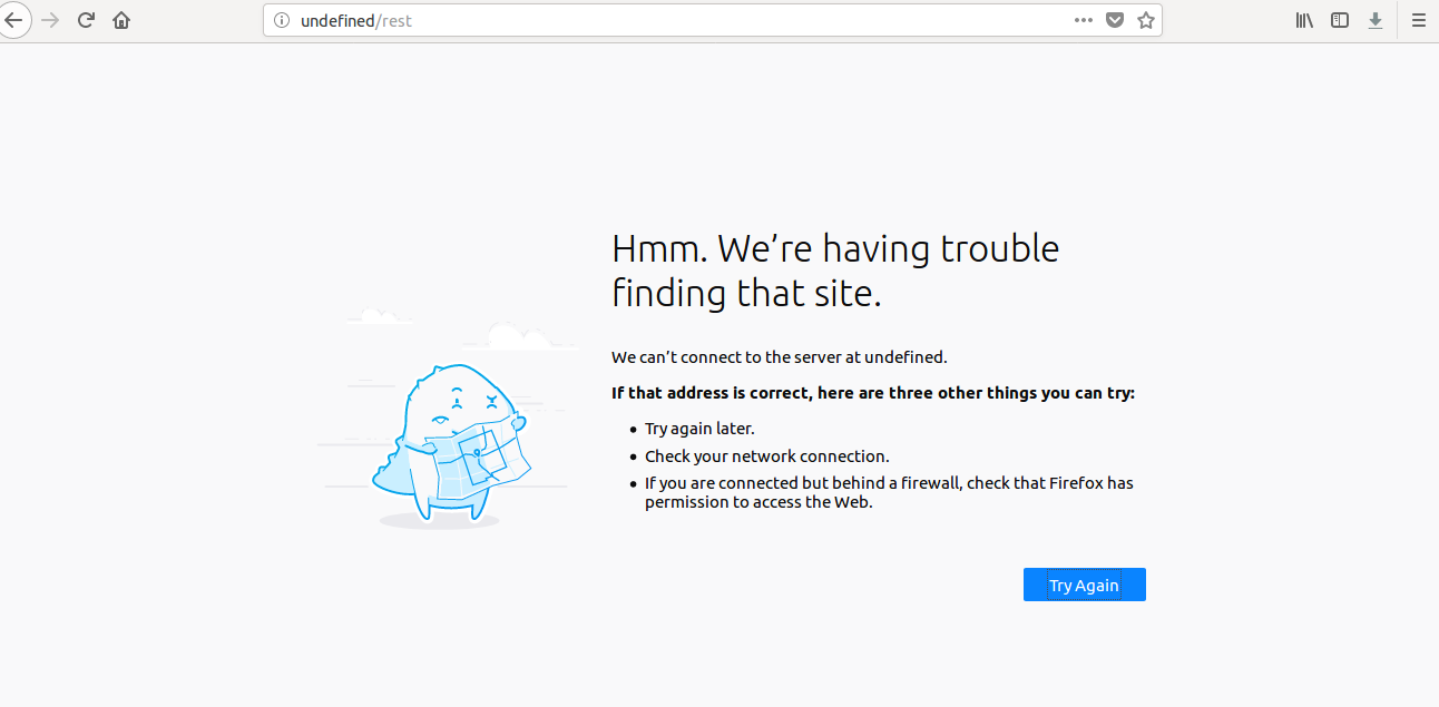

I wanted to access the openhab-cloud rest api but it is showing below error, what should I do ?
To access rest api, do I need to connect to Openhab instance using openhab cloud connector ?
Url: https://smarthive.fueblabs.com/rest
Screenshot%20from%202018-07-08%2012%3A55%3A12
Thanks.
After connecting openhab to openhab-cloud using cloud connector it is showing rest apis.
