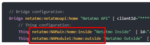

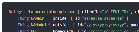

But I discovered that the wiki is not clear regarding the bridge and thing config of the netatmo binding.
Netatmo - Bindings | openHAB
Which one is correct?
With ipenHAB 2.4 I get this error when using the second configuration option.
Provide a thing type ID and a thing ID in this format:
<thingTypeId> <thingId>
The first option worked fine in 2.1.
So I think this has changed in 2.2 or 2.3.
Should I update the wiki?
Hi @christoph_wempe,
The first one is the preferred way (Changing to neatatmo 2.3 binding, unclear how to migrate from 1.9 - #4 by cweitkamp). It already has been changed in GitHub repository.
