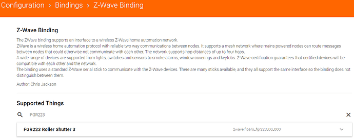

Go to the Inbox and have it ā€œsearch for thingsā€ with the zwave binding?
Strange Things…i see in the binding that the roller shutter 3 is now supported… but I can’t find it by ā€œstandard thing searchā€ā€¦ now I’m not even sure if the device itself is the problem… have to check this…:face_with_steam_from_nose:
When you list the bundle in the console, what version of the binding shows?
Sometimes it helps to delete all zwave things (in PaperUI) for your devices, but keep the controller thing (do not delete!) .
Then search inbox again (for zwave devices).
Did you INCLUDE it to your z-wave network before?
That is actually required, in order to pickup any binding changes. The controller is generic enough you just leave it, The Things are discovered with the same IDs so Items and rules do not break.
Do you mean this?
OK, the binding supports it now. Next step would be to INCLUDE it to your Z-Wave network, have you done that already? (It’s like pulling teeth from this guy. :wink: )
