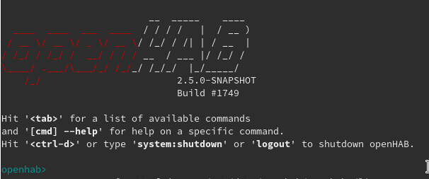

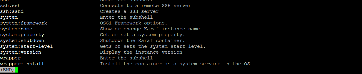

ajajaj - seems i am not even clever enough so handle the karal console … i’ve just startet with openhab-cli console … then typed “help” and now im caught in a loop :frowning: … what do i have to type to get out …?
logout or CTRL-D
can’t get out: after STRG-D i see this:
O… your in the help… CTRL-C or q
puuh - yepp … CTRL-C works … thanks!:star_struck:

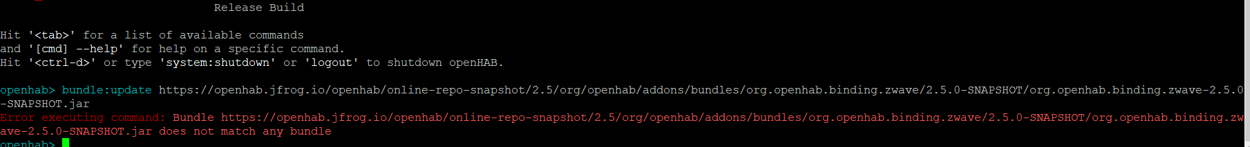

… oh, oh, … don’t work:
What do you see whne you run this in the console?
list -s |grep zwave
If you have manually installed the zwave binding, you need to delete the jar from addons. If you have never installed the zwave binding, you need to run bundle:install instead of bundle:update.
Although, I may understand this better… that message may be due to the version change. Uninstall the zwave binding…
bundle:uninstall org.openhab.binding.zwave
Then run…
bundle:install https://openhab.jfrog.io/openhab/online-repo-snapshot/2.5/org/openhab/addons/bundles/org.openhab.binding.zwave/2.5.0-SNAPSHOT/org.openhab.binding.zwave-2.5.0-SNAPSHOT.jar

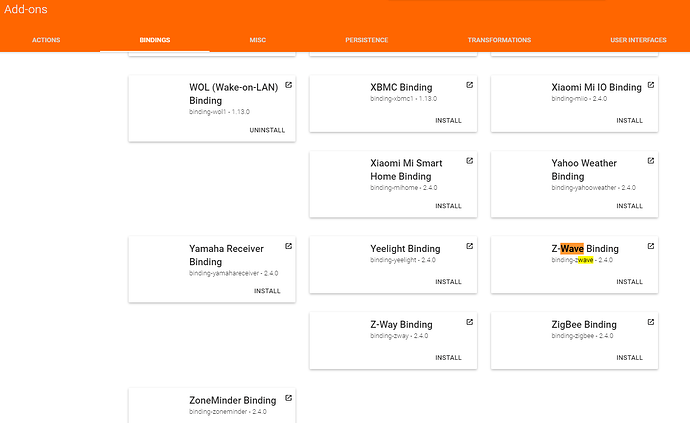

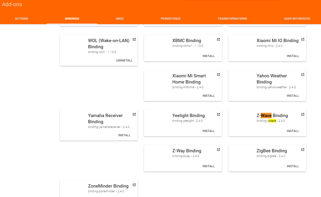

okay … uninstalled via paperUI … then startet the “Bundle: install …” … after a few seconds i had the prompt again:
… and after a reload of the Bindings in the paperUI nothing changed:
… maybe i make mistakes cause it’s 1:00am here :frowning:
You won’t see the binding in Paper UI. Did your zwave Things go online? Look under Configuration> Things. How about…

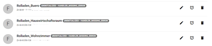

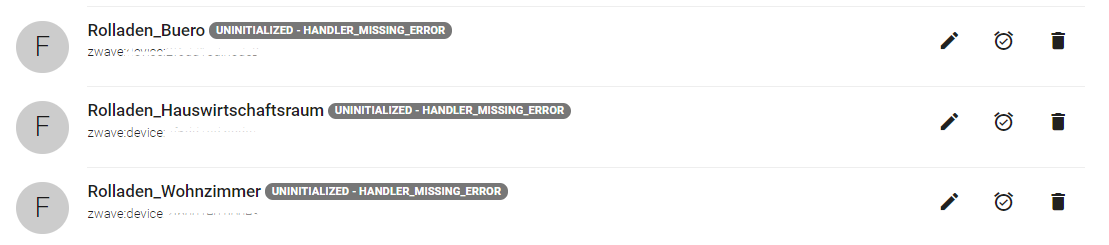

Mmmh Things are not online:
:frowning:
Is the binding active? Have you restarted OH? Do you have a controller Thing and is it configured properly? What do you see in the openhab.log after setting zwave to debug?
