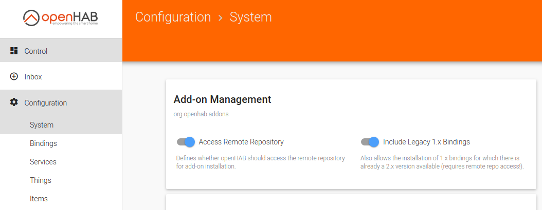

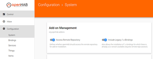

You can still install the OwnTracks (formerly MQTTitude) Binding after enabling legacy bindings:
Configuration → System → Include Legacy 1.x Bindings (press Save after enabling)
