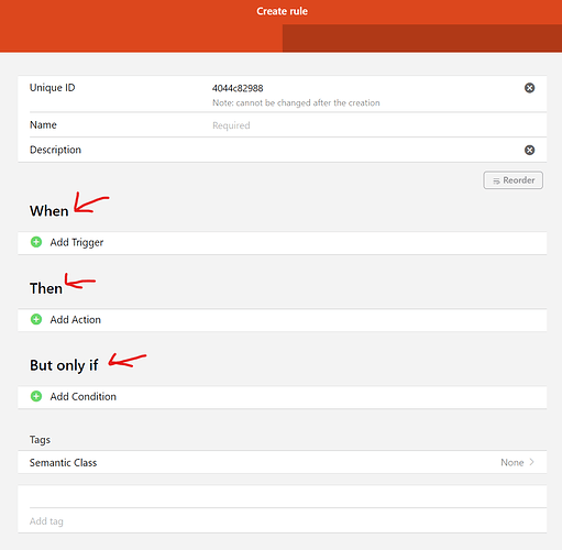

It should also be somewhat apparent on the Rule page where you create the Rule that a Rule contains three parts.
  • When: what events occur to cause the rule to run, i.e. triggers the rule. Can be time based or events on Items of Things. For example, when SmarthomeKalender_TitelaktuellerEintrag changes state.
  • Then: what to do when the rule is triggered. This is where your Blockly code would go
  • But only if: what conditions must be true to allow the rule to run even if it’s been triggered.
