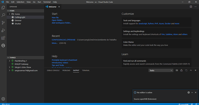

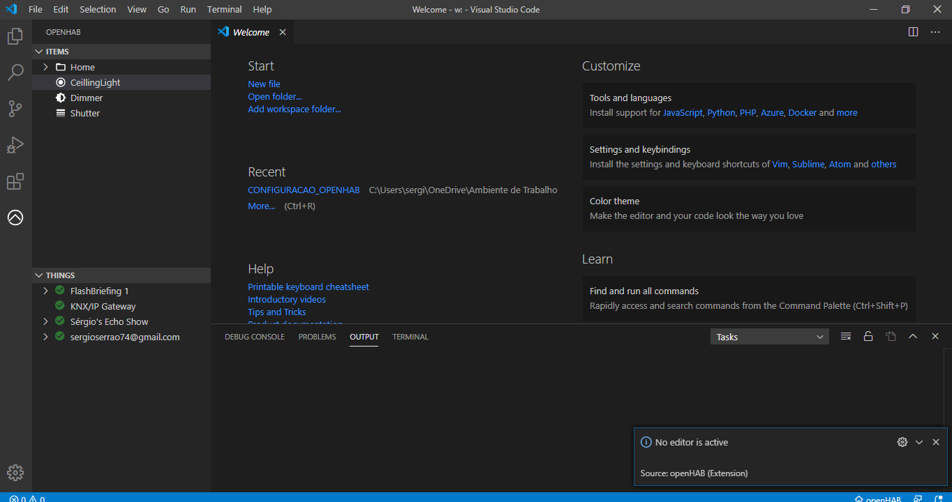

Yes I think so, there is another warning that can give a clue:
No editor is active
So what i see here is:
  1. Extension seems to be working basically :white_check_mark:
  2. Extension has a valid connection because it is able to show items and things :white_check_mark:
  3. You have no sitemap file opened. (which i think is the cause for your error.)
Without opening a sitemap file vscode and the extension don’t know where you want to add something.
We determine this with the active texteditor, because it is possible to have multiple sitemap/item/rule files.
Could you try to
  • open your openHAB config folder with vscode
  • open the sitemap file where you want to add something
    and then try the function again?
