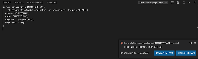

Error Message:
Error while connecting to openHAB REST API. getaddrinfo ENOTFOUND openhabianpi
The extension is trying to connect to openhabianpi instead of the adress you have configured.

The only output I get from there is
[Error - 10:03:05] Connection to server is erroring. Shutting down server.
