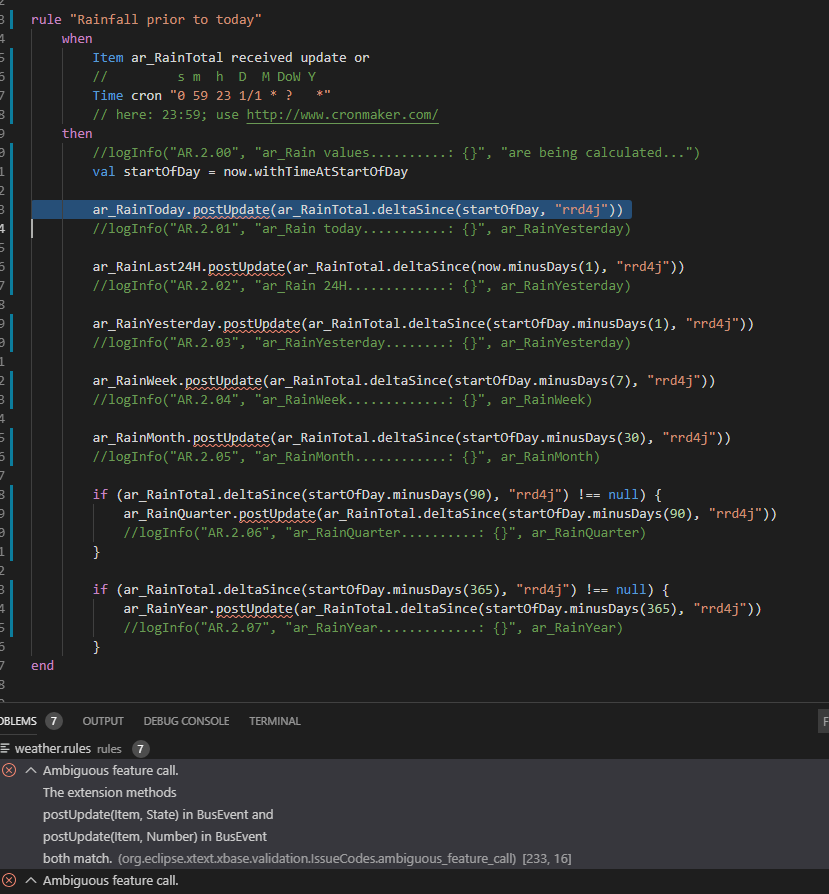

I am getting this error:
No idea how to get rid of it

This is telling you that postUpdate accepts 2 ways for typing the arguments
postUpdate(Item, State)
or
postUpdate(Item, Number)
VSCode is telling you that it doesn’t know with one to use as it can’t decide what type is ar_RainTotal.deltaSince(startOfDay, "rrd4j")
According to the docs:
<item>.deltaSince(AbstractInstant)
Gets the difference in value of the State of a given Item since a certain point in time
So you could try:
ar_RainToday.postUpdate(ar_RainTotal.deltaSince(startOfDay, "rrd4j%) as Number)

And this got rid of the error.
Thank you!
