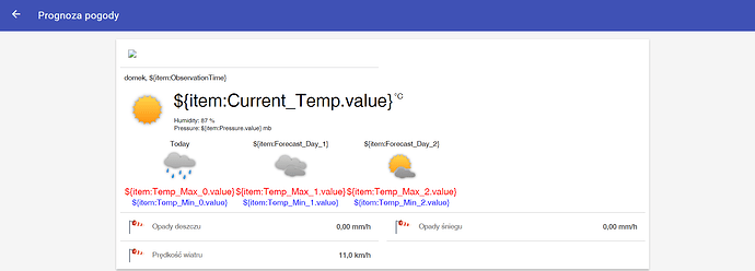

I have a problem with weather1 binding on openhab 2.4.0, I see icons on UI:
but i can see value and i do not know why, any sugestion?

openhab.log is clear, anything about weather1.
Problem is only with value on webview, example.html is orginal:

You did not show all item definitions, additionally the items used in the .html file are the same as in the items file ( for example Temp_MinD versus Temp_Min_0)
I show all weather items whitch i have in home.items file.
not ecsacly, because this configuration worked under openhab2.0.0
$ {config: name} - interprets correctly and on the web is “domek” but
$ {item: ObservationTime} or $ {item: Snow} (Snow its item from .items) - not want to show a parameter

OK, its working
In example.html are different tokens:
${config:name}, ${weather:condition.observationTime(%1$td.%1$tm.%1$tY %1$tH:%1$tM)}
${weather:temperature.current(%.1f)} °C
Humidity: ${weather:atmosphere.humidity} %
Pressure: ${weather:atmosphere.pressure(%.1f)} mb
Today ${forecast(1):condition.observationTime(%1$tA)} ${forecast(2):condition.observationTime(%1$tA)}
${forecast(0):temperature.max(%.0f)} ${forecast(1):temperature.max(%.0f)} ${forecast(2):temperature.max(%.0f)}
${forecast(0):temperature.min(%.0f)} ${forecast(1):temperature.min(%.0f)} ${forecast(2):temperature.min(%.0f)}
