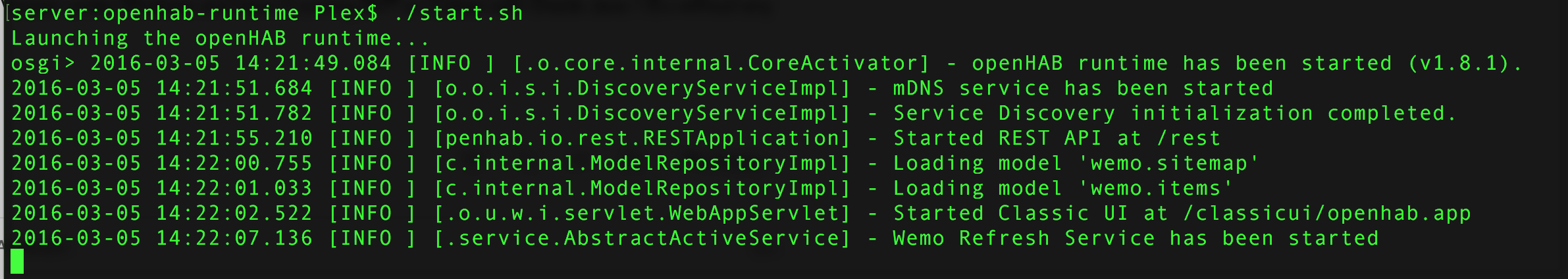

I’m running:
Mac OS version 10.9.5.
Java Version 8 Update 73 (build 1.8.0_73-b02)
javac version 1.8.0_73
And here’s a screenshot of the openhab runtime:

bradleyshaw:
Any ideas?
If there is any other software listening on the used ports, you would get different errors. So in your case, I would assume that something is blocking UPnP traffic completely. Please check your router settings.
Furthermore, please report your WeMo devices firmware versions here.
I upgraded to the latest wemo firmware, which is now 2.00.10626 as per the attached. I’ll check my router settings and let you know, thanks.
It was my router settings; now I’ve sorted that out (I had a number of different wireless routers setup with WAN connections to the modem rather than as Access Points) I’m up and running.
Cheers for the assistance!
