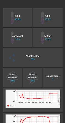

I think we can skip that. Because in the meantime I played with Habpanel and this worked perfect for me!

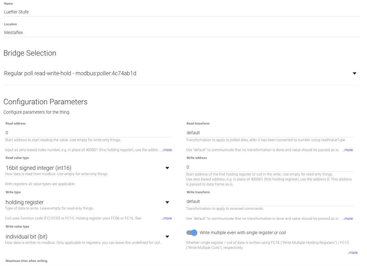

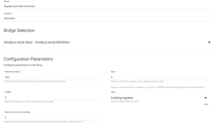

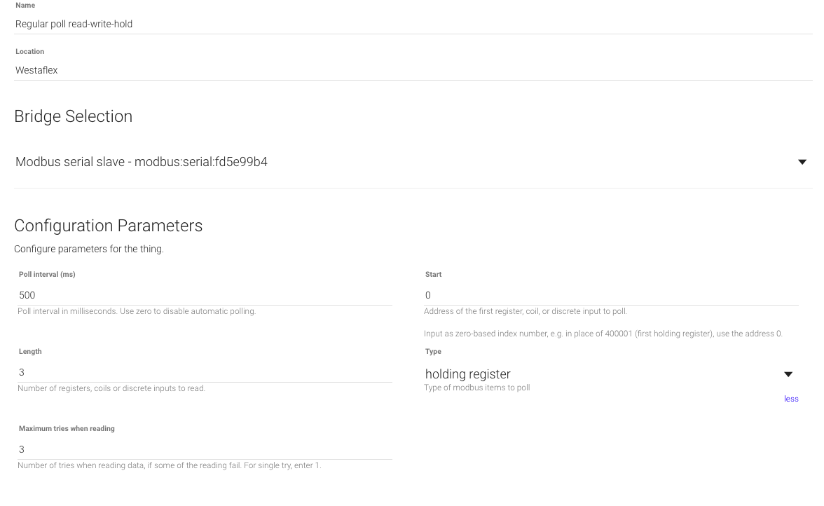

I added a poller thing:
and then the data thing:
But i receive some Errors in the log:

Okay, I thought you were already reading holding register 0-3. But if you weren’t already, the new poller looks fine.
The poller only deals with reading, nothing to do with writing.
So let’s go one step at a time.
Set up your poller and data things and Items so that you can read those three registers from the AC unit.
Get that working before thinking about writing.
When it does come to writing later, you’ll be wanting the same 16-bit type as the read (not single bit) and you don’t usually want the write-multiple option. The only thing that will need changing to allow write is the data Thing for the channels you want to write.

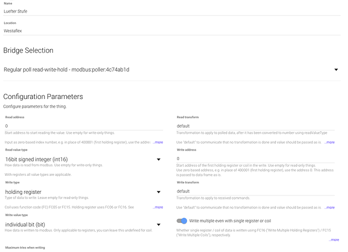

Now I want to know how to write the number in to that register
Edit:
The Writing is working also for me!
Thanks rossko57
It’s not complicated, in the data Thing you add the write Start (same as the read Start) , the write value type (same as), write type (holding).
That’s it, send a command to your Item from rule or UI and it gets written to modbus.
In this case, it’s up to you to manage only sending sensible commands
(0-3)

Yep! Now everything what I need for the moment is working very well!
Hopefully it helps other Westaflex Wac350 Airvent Units users to connect thier unit to the Openhab!

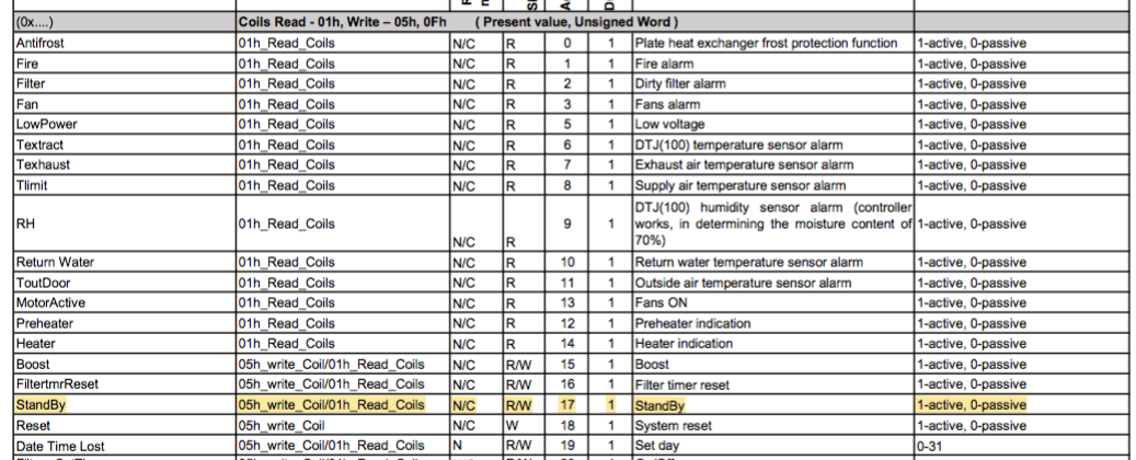

But now again iam struggeling with adding a new modbus Read/Write thing.
Here marked yello is the Modbus Adress i want to Read/Write:

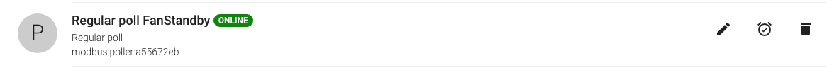

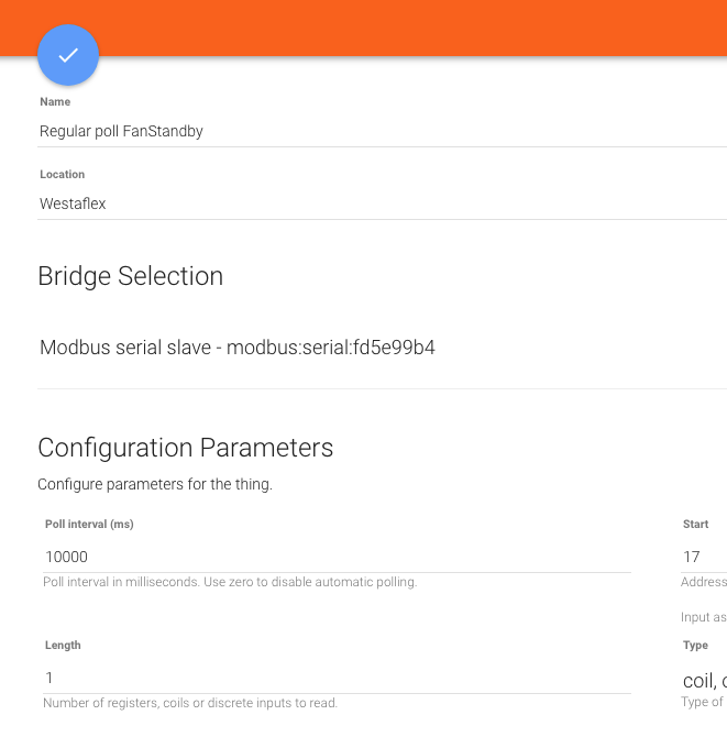

Then i added a “PollerThing” for those:
And this Poller seem to be working:

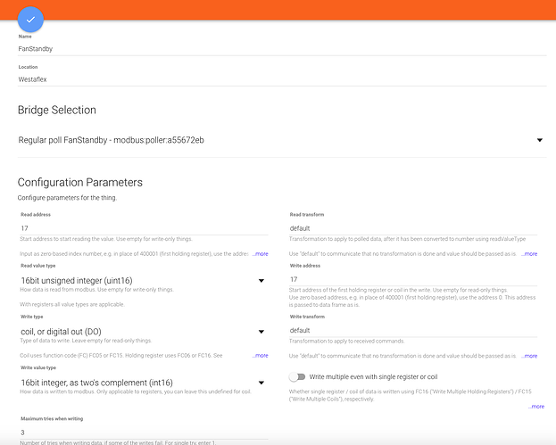

And then the “DataThing” for those Poller:
But the “DataThing” will not work:
Here´s a Message from the Log:

I suspect this is as simple as naming your poller FanStandby and also your data thing FanStandby.
You’ve got to give them unique names.
To save madness, consider calling your poller WestCoils or something like, and data thing wcoil17 or suchlike. So far as Modbus goes, these are just registers.
Your Item is the part you want with a meaningful name.
I’m guessing you’ll expand this poller to get some of the other functions and alarms eventually.
But of course any naming scheme is up to you.
So, I tested with differed names.
No changes
This error message is not coming from the poller you showed us, which is for coil start 17 length 1
The dat thing you showed us (for a coil), you have set to read uint16 type (incorrect) and write bit type (correct).
Hello rossko57,
thank you for your hint with the “bit”. That solved the problem.
And now its clear for me, because as far as i understand a coil can´t be a Number.
A coil must be a bit because of “0” or “1”.
