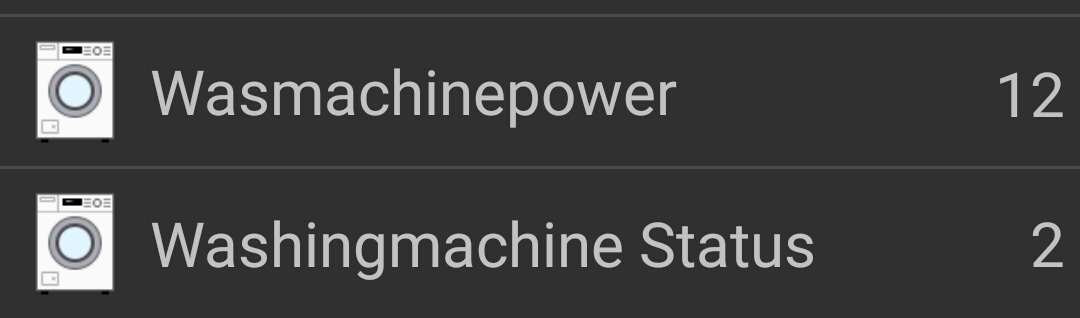

in my basic UI it looks like this
and in my phone app like this

Now something odd happens.
My basic UI now looks like this, what i expect, but I have to give a refresh before it appears.
However, my phoneapp just refuses to open the group that the washingmachine is in. The moment I remove the MAP command, it opens immediately again, but when I add the map, the group won’ t open.
