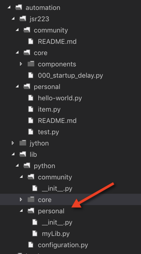

Where do I put library modules which can be imported by other modules?
I have created in personal:
myLib.py

putting the file in “lib/personal”
and refencing:
from  personal.myLib import  myLog
myLog("Hello World")
