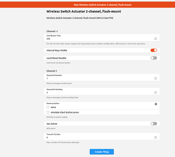

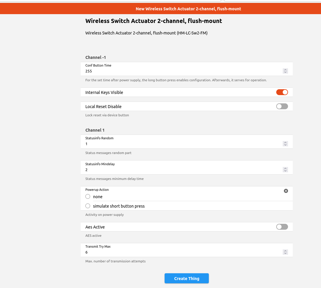

Only “Channel 1” of a "Wireless Switch Actuator 2-channel, flush-mount (HM-LC-Sw2-FM)" can be controlled over the OH3 UI.
no second channel
