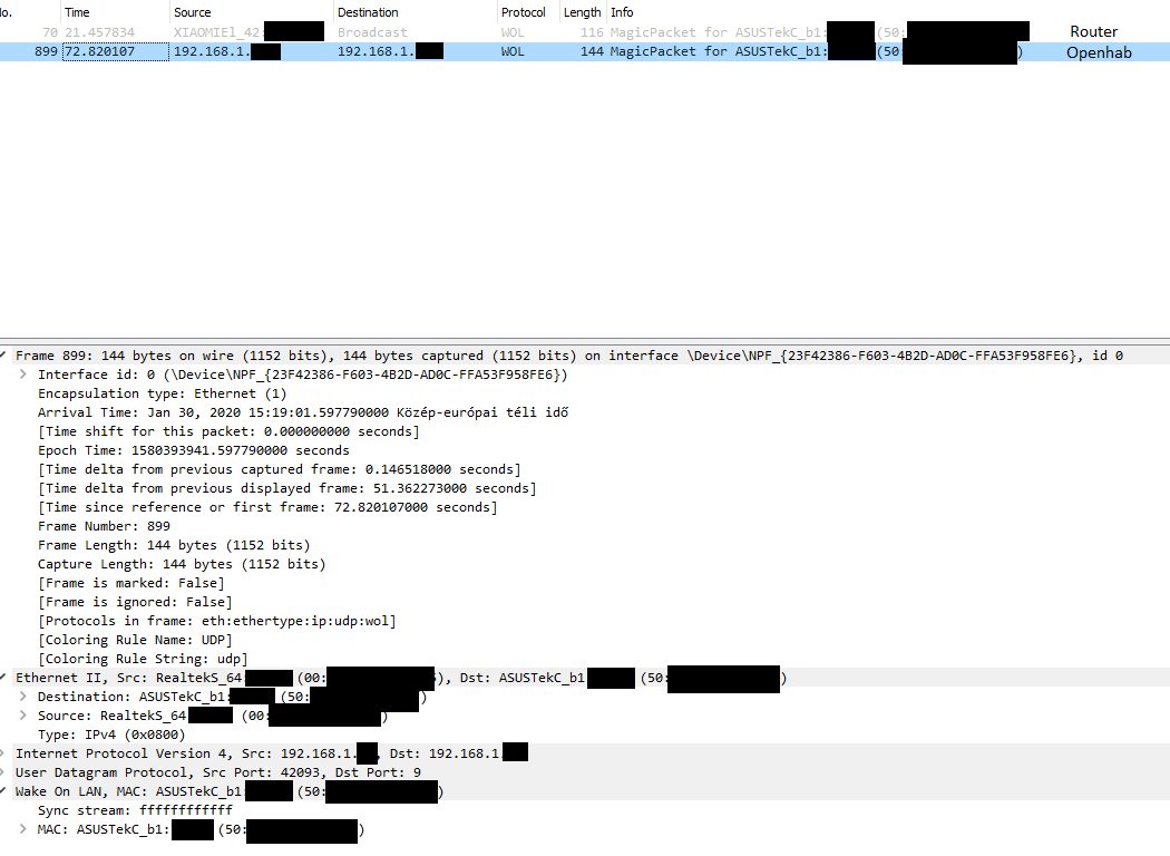

I logged lan wol packets with wireshark: (Logged with “destination pc” with wireshark, pussh router wol function button and activate openhab wol binding)
- Openhab magic package type: IPv4 (0x0800) / Destination: AsusTek_4e:o7:98 (my pc mac address)
- Router magic package type: Wake On Lan (0x0042) / Destination: Broadcast (ff:ff:ff:ff:ff:ff)
UPDATE
SOLUTION:
- setup static ip on router
- setup static ip on “destination pc”
- NIC config: Enabel wol, magic package
Disable energy saving, deep sleep - BIOS config: Enable wol
- add static ip to the linux server ARP table
arp -s IP MACaddress
(After shut down destination pc the linux server arp cache cleared 10-15 mins later.)
