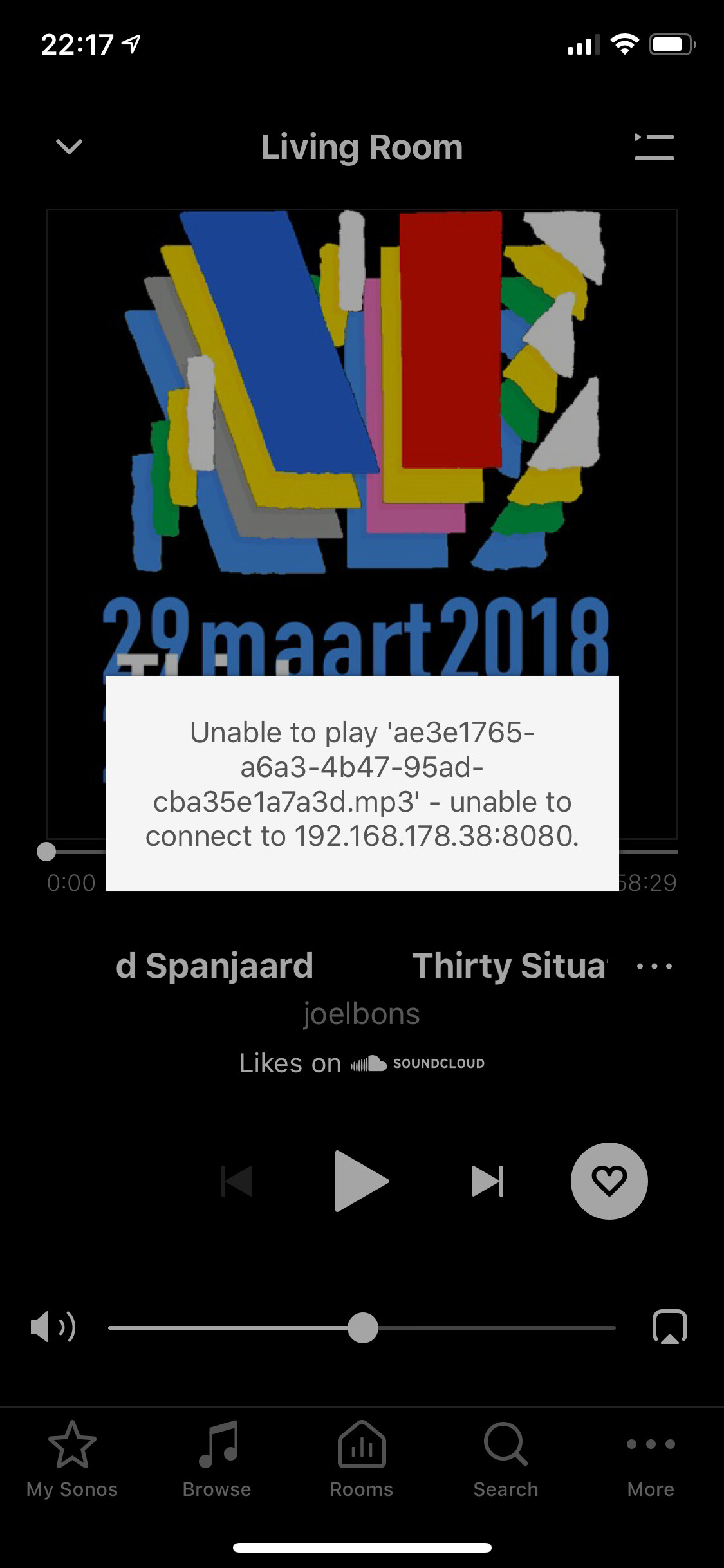

I am trying to use a Sonos One as an audiosink. When I do
smarthome:audio play barking.mp3
in the console the uri of the file is send to the Sonos speaker but it looks like th uri has the wrong ip address in it. I gather that from the following error in the Sonos app:
Unable to play ‘XXXXXXXXX.mp3’ - unable to connect to 192.168.178.38:8080.
That ip (38) is the ip of the Sonos and not that of Openhab. Openhab is 21.
