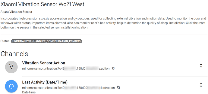

nevertheless, the Vibration sensor is shown offline:

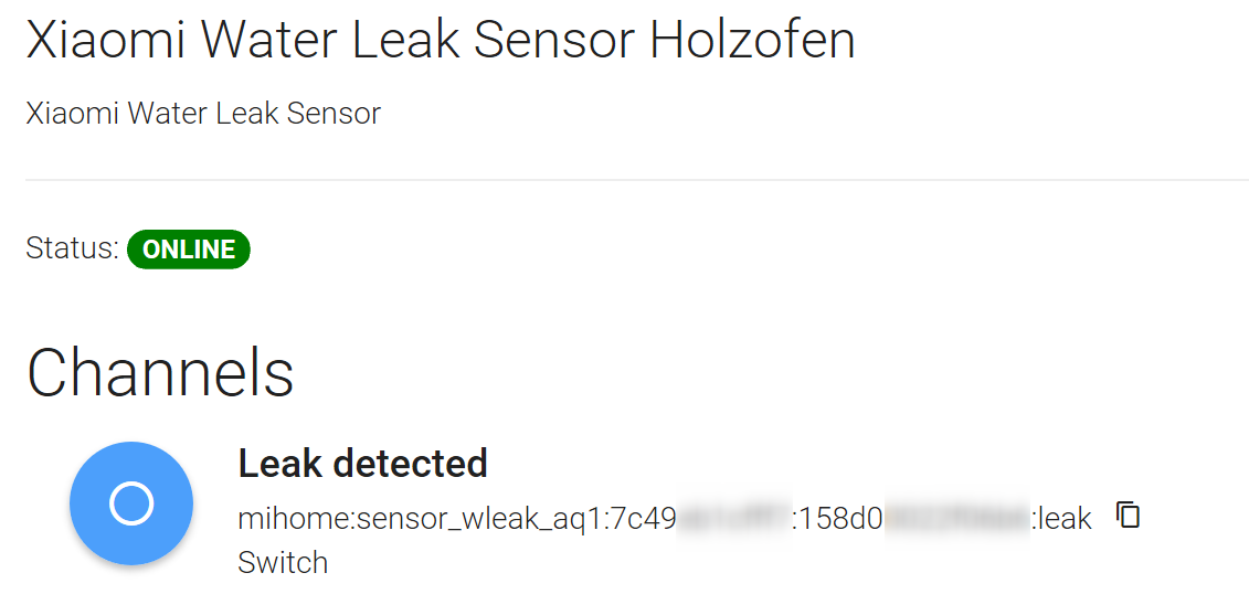

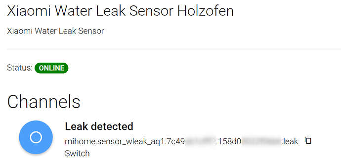

whereas the other sensor are online like:

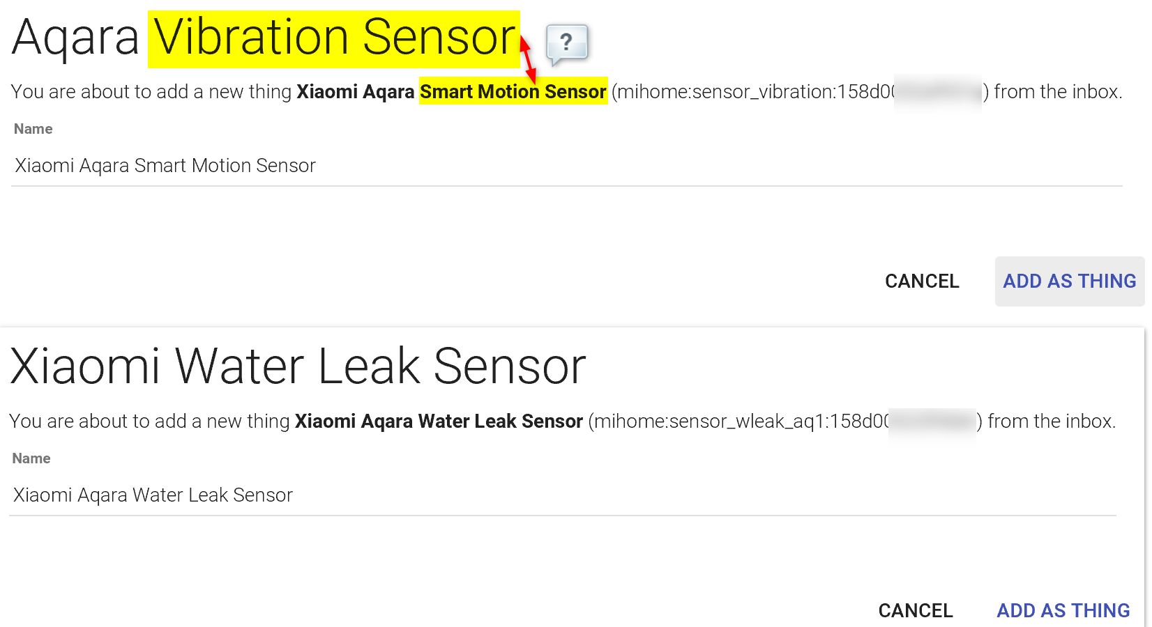

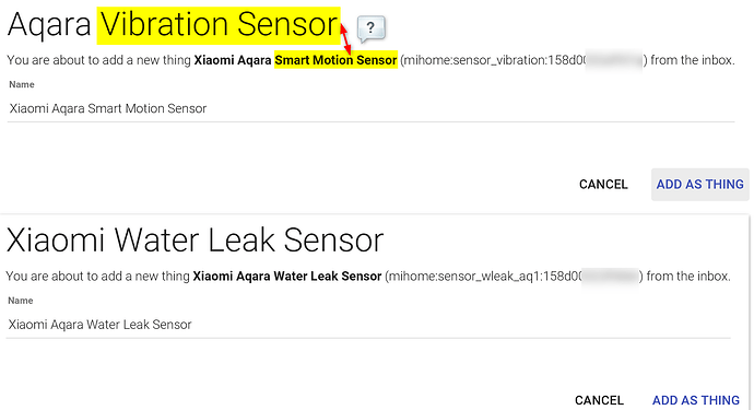

My Inbox Shows this:
so, the sensor is found - and I could use it I guess, but I’d like to have it within my Things file - not in the PaperUI only.

as you can see, the Vibration sensor stays in “HANDLER_CONFIGURATION_PENDING”…
Do I miss something or is the 2.4 snapshot binding not ready for text-Thing?
