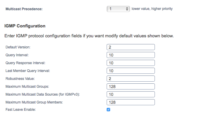

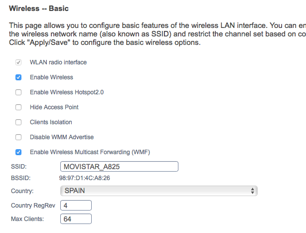

I’ve tried to enable multicast in my router with high priority:

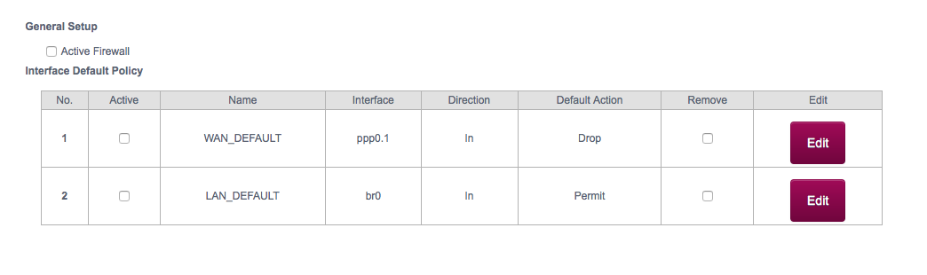

and also disable firewall

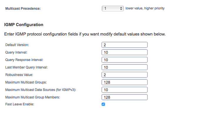

and doing the same with WAN
But it’s happening the same there is somewhere can i enable multicast?
