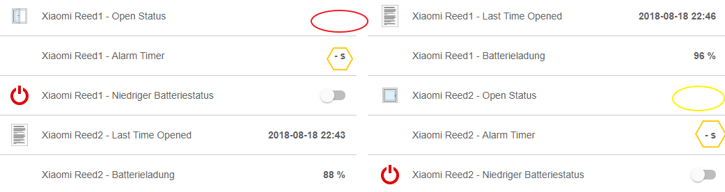

I’m a bit confused about how to integrate the xiaomi door sensor in my sitemap.
According to the log the reed contact recognised the change:
2018-08-18 22:46:36.074 [vent.ItemStateChangedEvent] - out_xiao_reed1_isopen changed from CLOSED to OPEN
2018-08-18 22:46:36.095 [vent.ItemStateChangedEvent] - out_xiao_reed1_lastopened changed from 2018-08-18T22:33:35.844+0200 to 2018-08-18T22:46:36.057+0200
But in the sitemap only the icon (window) changes from closed to open - there is no closed/open text right to the item name “Xiaomi Reed1 - Open Status” (see screenshot)

Contact    out_xiao_reed1_isopen          	"Xiaomi Reed1 - Open Status [%s]"                                         (Gxiaomi,Greed)       {channel="mihome:sensor_magnet:zzzd0001xxxxxx:isOpen"}
Many thanks!
Quite obvious - I should go to bed now :wink:
