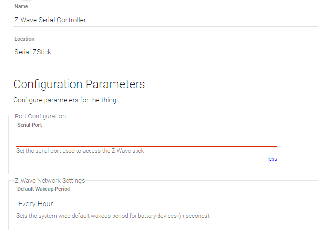

installed openhab2 no problem..using a aeon labs gen 5 USB stick to connect to a z-wave network. the problem is that i have added the z-wave binding but i cannot find the usb port(serial port) to connect to it. tried everything…can somebody point me in the right direction???

This is system dependant, so it will depend on how your OS works. If this is a linux, or mac based system, then ls /dev/tty* will list all the serial ports.

Remove the stick, list the ports, add the stick, then list them again and pick the new one.
Tried that, identified the port as /dev/ttyAMA0 but still no comms, a bit strange, I know the stick works
comming up with Status: OFFLINE - COMMUNICATION_ERROR Serial Error: Port /dev/ttyAMA0 does not exist
very strange when the port is definetly correct
You need to make sure that the openhab user has permission to read/write to /dev/ttyAMA0.

openHABian sets the permissions correctly for you. Run openhabian-config, go to 30 System Settings, 35 Serial Port, make sure that option 3 “Add common serial ports to openHAB JVM” is checked. Then go to 10 “Apply the latest improvements to the basic openHABian setup” and 14 “Fix Permissions” .
This will set all the permissions appropriately.
