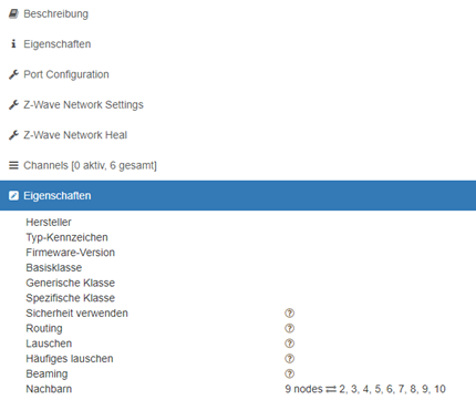

Hello folks,
I have a quick question. Are the zwave controller properties suppressed/hidden in Habmin/PaperUI view?
here is XML file of my controller, node1:

And here are the shown properties (=Eigenschaften) in HABmin: only the neighbors (=Nachbarn) are shown!
If hidden, why is this?
It is not hidden - it’s just not known for the controller since the controller does not implement the same command classes (in fact - any command classes!) where much of this information comes from.
I conclude that the view in HABmin actually is correct?
Yes, it contains the known information about the controller - we just don’t have the same functionality and information for the controller as other devices as it’s a very different device.
