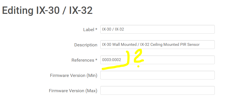

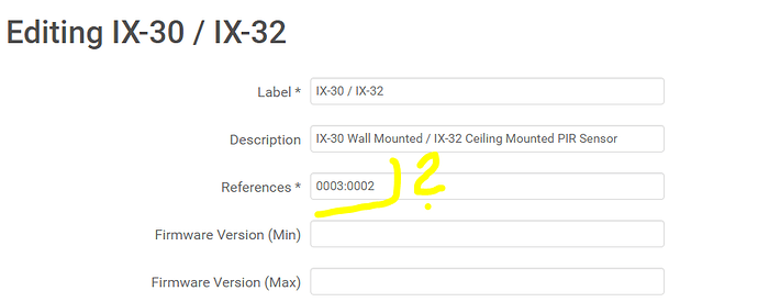

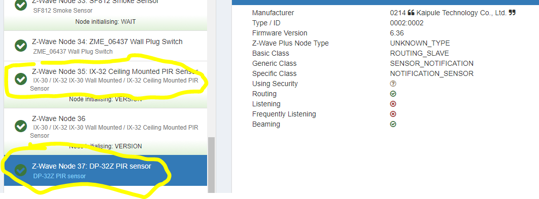

I have 2 PIRs from Kaipule … both have the same enclosure and a sticker IX-32 on them but or discovered as different things as they have different Type / ID.
One is disovered as IX-32 and the other as DP-32
IX-32: http://www.cd-jackson.com/index.php/zwave/zwave-device-database/zwave-device-list/devicesummary/667
DP-32: http://www.cd-jackson.com/index.php/zwave/zwave-device-database/zwave-device-list/devicesummary/559
I am pretty confident they have the same Parameters and so on.
Is it possible to handle them as the same thing by adding the Type / ID from the DP32 to the IX32?
If so … should the DP32 be deleted then?
thanks!
What a pain :wink: (not you - the manufacturer :slight_smile: ).
Yes, it sounds like you are probably right and I’ve made the changes… (you might want to double check…)
thanks! :slight_smile: looks fine

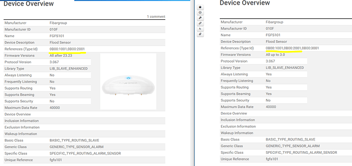

if there are 2 things with the same type:id… how does the binding decide for discover / initalization which is used?
Thanks :slight_smile:
First point - this shouldn’t happen - or shouldn’t be allowed at least… There are checks in the database to try and raise an error if this happens, but I suspect it’s not 100% guaranteed to catch all instances as it’s a little complex.
The binding will use the first set that matches the criterea.
Now - the extended answer…
There are 4 numbers used to match the thing - the manufacturer code, the device type and device ID, and the application firmware version. So, in the case you have above, these two devices are not the same and will not conflict as they have different firmware versions. One device is version 0 to 3, and the other device is version 23.23 to 255.255 (which is the maximum version possible).
