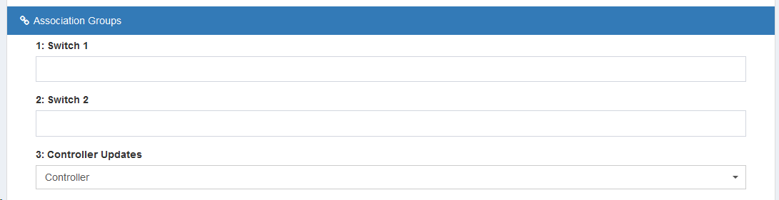

Thanks a lot. It helps. I changed all Association Groups to controller and it working.
Appreciate.
You should note that this will likely cause problems as the binding will now likely receive multiple (duplicated) messages. You should only need to set the lifeline, and if you are using 2.5 this should be done automatically.

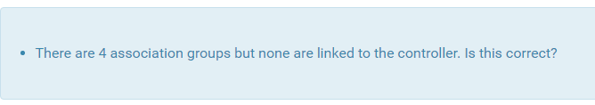

Does that mean a check and warning can be removed from the database?
I’ve no idea as I’ve not looked at the database definition - what check are you suggesting to remove?
An example from item 74 (chosen at random)
This is a question about adding a checkbox to one of the association groups. I’ve not looked at hte device so I don’t know if it should be added. This is basically displayed on the premise that for most devices there should be at least one association linked to the controller so that the controller knows what is happening.
What we are talking about here is if the user manually adds the controller to ALL associations, then there will be duplication.
Again - here I thought your question was about removing something on a specific device. I’m not sure how to answer your question if it is of a more general nature?
More generally, is that database check still needed if the binding automatically links a group to controller?
That was my, admittedly general, question.
