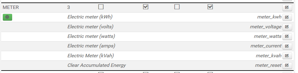

I have some aeotec DSC19 dimmers that used to have a KWH meter reset switch but it no longer shows in the list of channels. At some point these it did have a switch and I have an item bound to the channel, but the channel is no longer present. I don’t look at the readings from these terribly often which is why I missed it for so long.
https://www.cd-jackson.com/index.php/zwave/zwave-device-database/zwave-device-list/devicesummary/79
This device has not been updated since three years, I think that channel did never exist:
grafik
:joy: ooops. well, could i get that channel? :slight_smile:
Sure, done:
Please report back it it is working with that device, if not, we need to revert that change. Thx.
