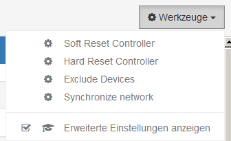

I have the AEOTEC ZW100 Stick with a few devices, which are working fine; but what’s quite annoying is/was the fact that I always have to unplug the stick to get it into inclusion mode to include new z-wave devices. (With all the hassle afterwards configuring the port…)
I know this topic isn’t new, there are quite a few postings on this. The solutions seems to be to activate the inclusion mode via HABmin, but I do not have - or at least see - this option, see screenshot:
I appreciate any advice!
This is the button to push:
YES !! That does the trick - thank you @sihui :grinning::+1:
