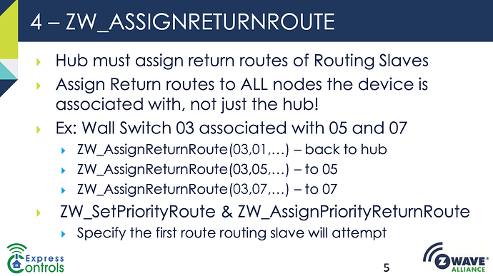

Why is that? Has this changed in the latest SDK? Previously the controller is in charge of setting the routes, but are you saying this has changed?
Because the LWR will correct based the PWR or one of the neighbours unless all neighbours tried are now not working. Yes if all the neighbours tried are now not routable they need clearing and if there are a lot of neighbours it only tries a few of them so things can fail to self heal. If the new LWR is reliable again then it does indeed self heal.
I have never been clear from the docs if when an explorer frame finds a route this also becomes LWR. I think it does sometimes from experimentation. When things settle hopefully it settles to LWR, PWR.
So your point is that routing slaves are now able to create their own routes rather than these being defined by the controller software as has been the case? Do you have a reference for this?
From your post, you are saying that the controller no longer needs to define the routes between different devices? It would definitely be good to get a reference for this in the docs.

Yes, but again, this is the controller side - not the slave. The big question is what SLAVES do and this is one of the main things that is addressed in the heal. If slaves are unable to find their own routes (which is not uncommon) then they must have routes set for them by the controller using the ZW_AssignReturnRoute command. This is why you need to be careful with statements like the system should self heal.

FYI -:
This comes from one of the Silabs FAEs, so again, it seems to indicate that routing slaves do not derive their own routes, and they must be set by the controller.
Agreed but once set they are managed.
