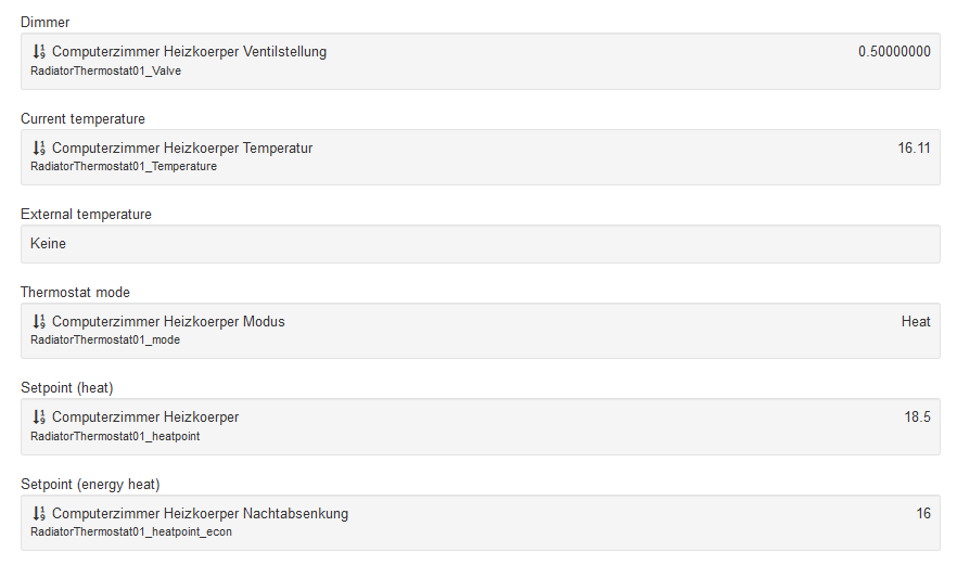

Screenshot from habmin, the temperatur value was restored from mapdb not a real value from binding! Maybe misleading:

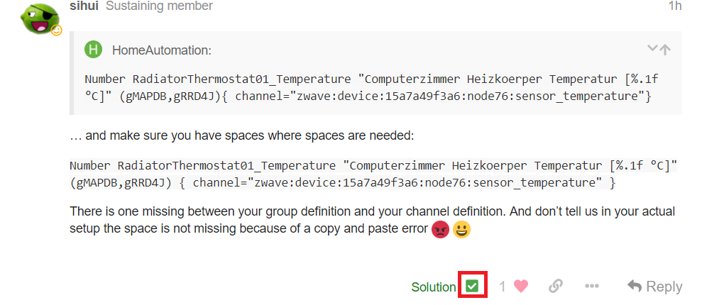

… and make sure you have spaces where spaces are needed:
Number RadiatorThermostat01_Temperature "Computerzimmer Heizkoerper Temperatur [%.1f °C]" (gMAPDB,gRRD4J) { channel="zwave:device:15a7a49f3a6:node76:sensor_temperature" }
There is one missing between your group definition and your channel definition. And don’t tell us in your actual setup the space is not missing because of a copy and paste error :rage: :grinning:

You are right, there are no spaces, but in no of my other items there is a space, and all others are working fine. I will try it.
This does the trick, thanks a lot!
But I not really understand it. Only this item in affected by the missing spaces. All my others are working fine :wink: But good to know this.

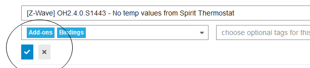

How to unmark the solved?
I updated the thread title
In theory, you should be able to uncheck the solved mark…

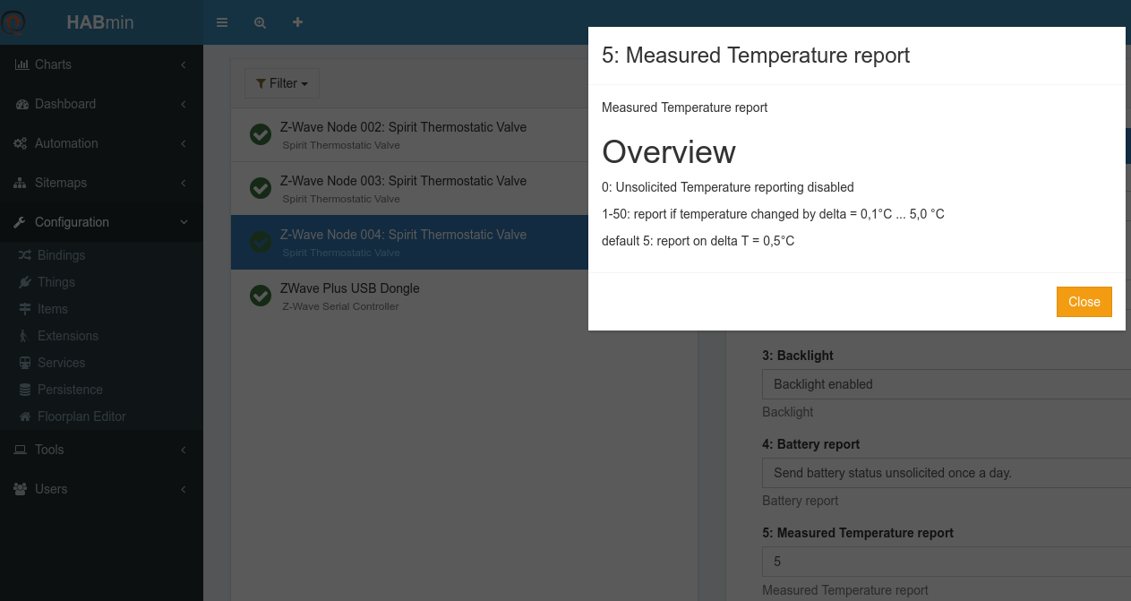

Have you checked the configuration parameters of your Spirit?
Yes it is 5. As before in OH2.3.
I made a screenshot of every setting before migrated to OH2.4 snapshot. For some devices I had to re-adjust the settings but for the radiator thermostat all was and is correct.
Could there be something wrong with the association settings?

Is this the solved mark you mean?
