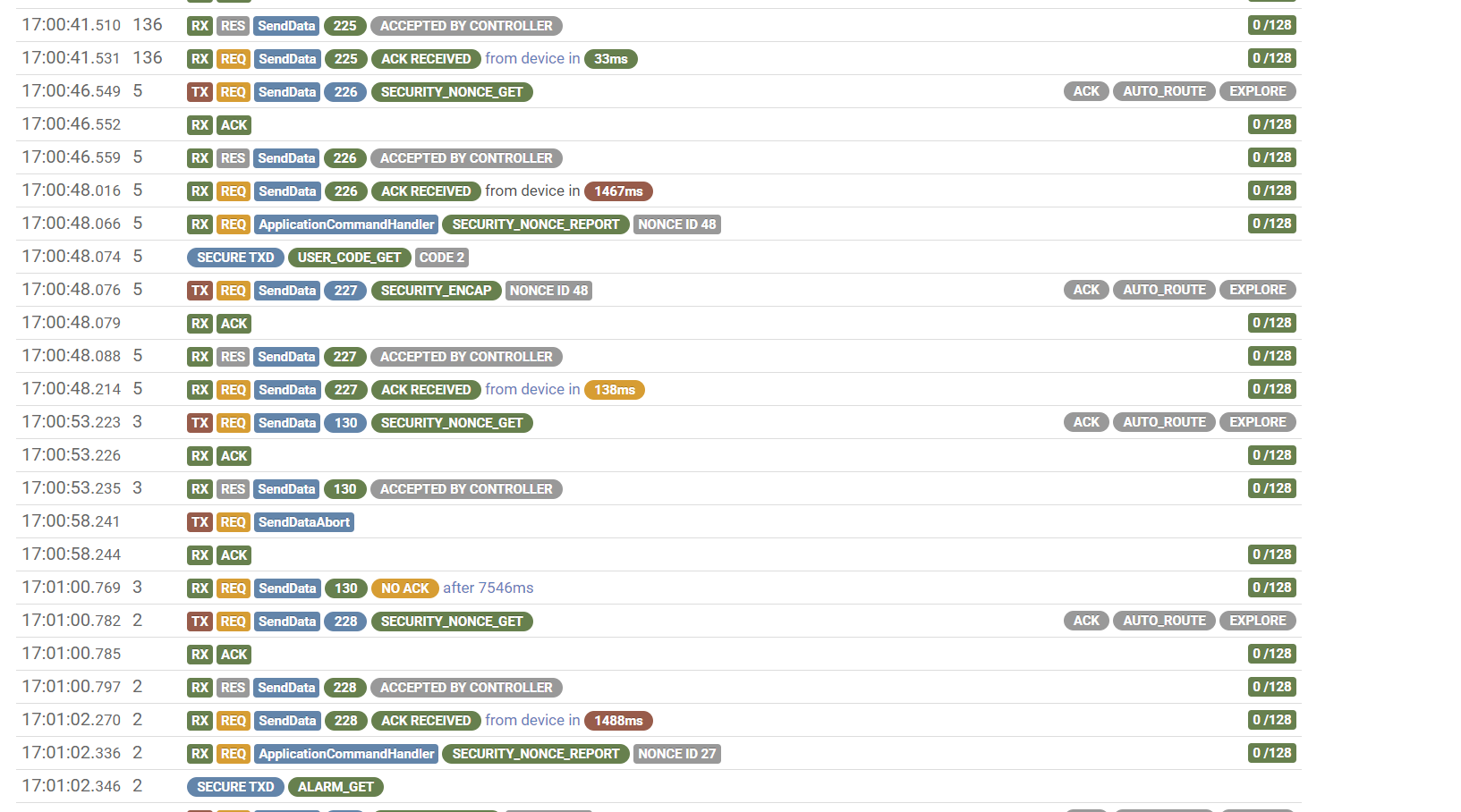

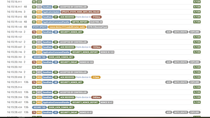

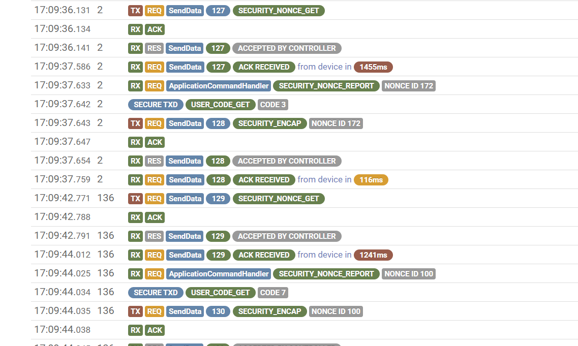

That would all be good but for hour on end your config is talking to one of your secure nodes every five seconds
and on
and on and on
and they do seem to always take a lot longer than my secure nodes to return a nonce so and that is from the controller. All those seconds when the controller is waiting it can send no more commands.
In general terms you also have an odd node that occasionally spams your network but this traffic is for hour on end.
And then because your network is so busy incoming reports and outgoing requests

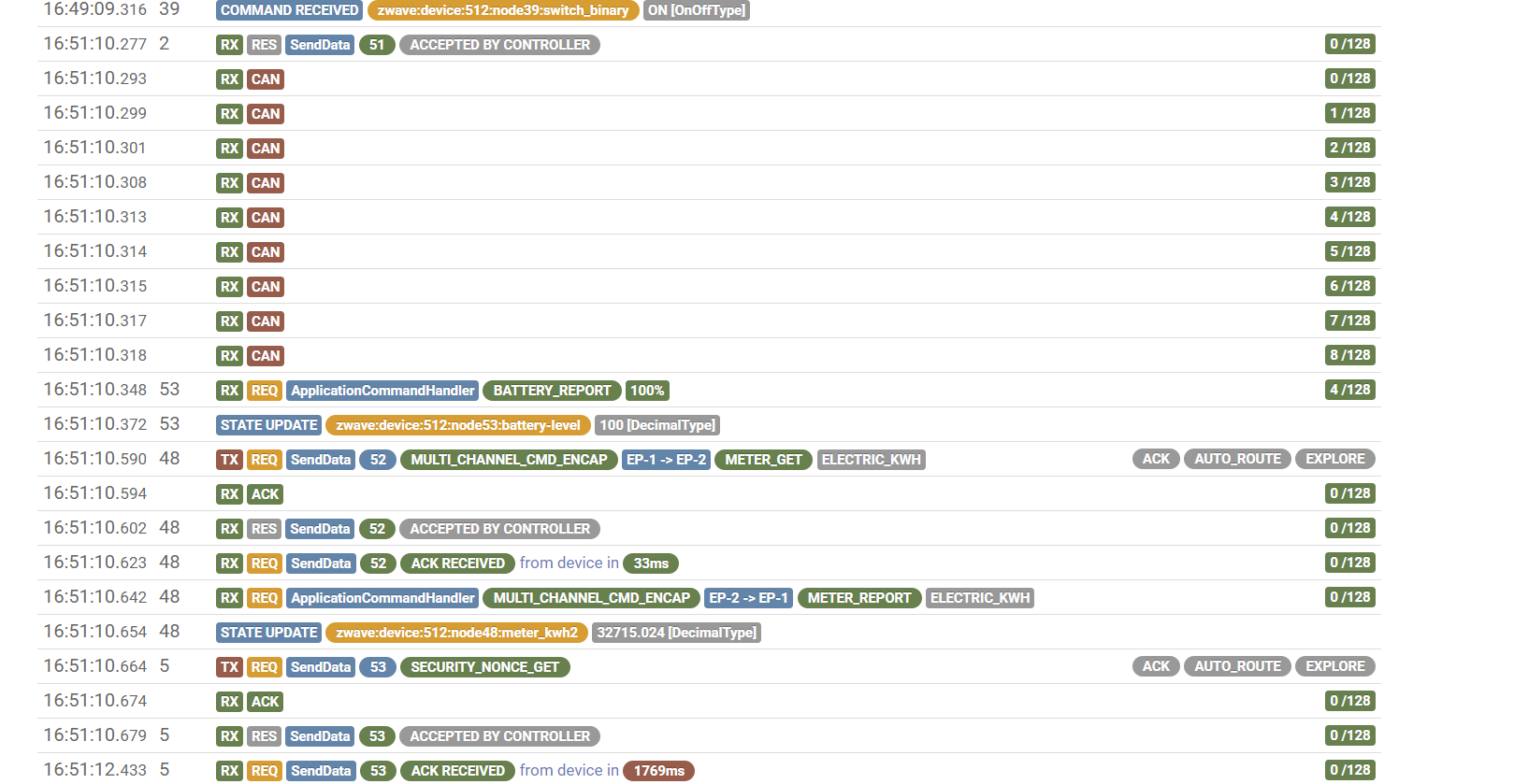

You get a load of CAN
As you are an IT pro.
I get 0 CAN with 150 nodes other than 1 or 2 at system start.
If you are getting these your configuration and network health needs looking at. There is nothing that can be done about these. The controller is a serial connection trying to do async communication and there is nothing wrong with how the binding is controlling this.
Seriously get yourself a zniffer to see the actual packets and tune down your traffic and you will have a more robust network.
