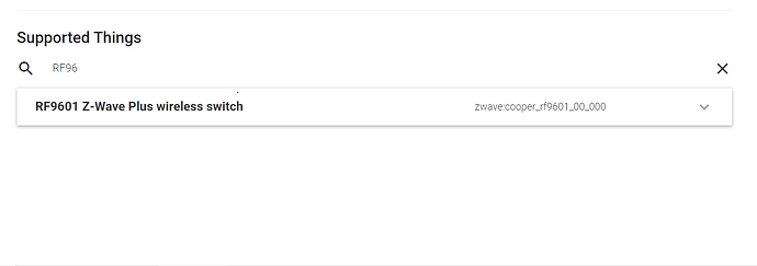

I am running openhabian with the latest testing/milestone build. Over the past few weeks I have setup setup and configured about 40 z-wave devices in my openhab setup. Today I was cleaning up some entries in Paper UI and started to get a 500 server error when going into the properties for some devices. After doing some investigation, it appears that the z-wave binding is not showing many of my devices as supported devices. They are in the z-wave database because I was able to do the initial setup and I contributed to having the devices added to the database.
Screenshot above shows only one RF96xx devices supported. There should be at least 4 different device models supported in RF96xx series.
I uninstalled the binding, cleared the cache, and reinstalled the binding. I also tried stable openhab builds. Everything was almost working the way I wanted to it and now a seemingly random number of devices are missing from the z-wave database. HABmin has the items with the missing device database entry grayed out. I would really hate to have to start over.
