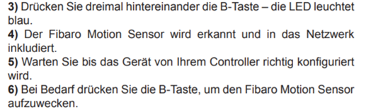

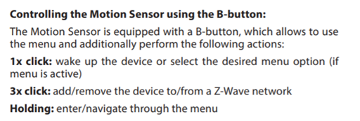

Here is why I thought it’s “tripple pressing”: it was not translated correctly!
english:
german:
3).. dreimal = 3x
6) …“drücken” = press (but not how often!) …“aufzuwecken” = “to wake it up”
Better would be “drücken Sie einmal” = “do press once” :smiley:
