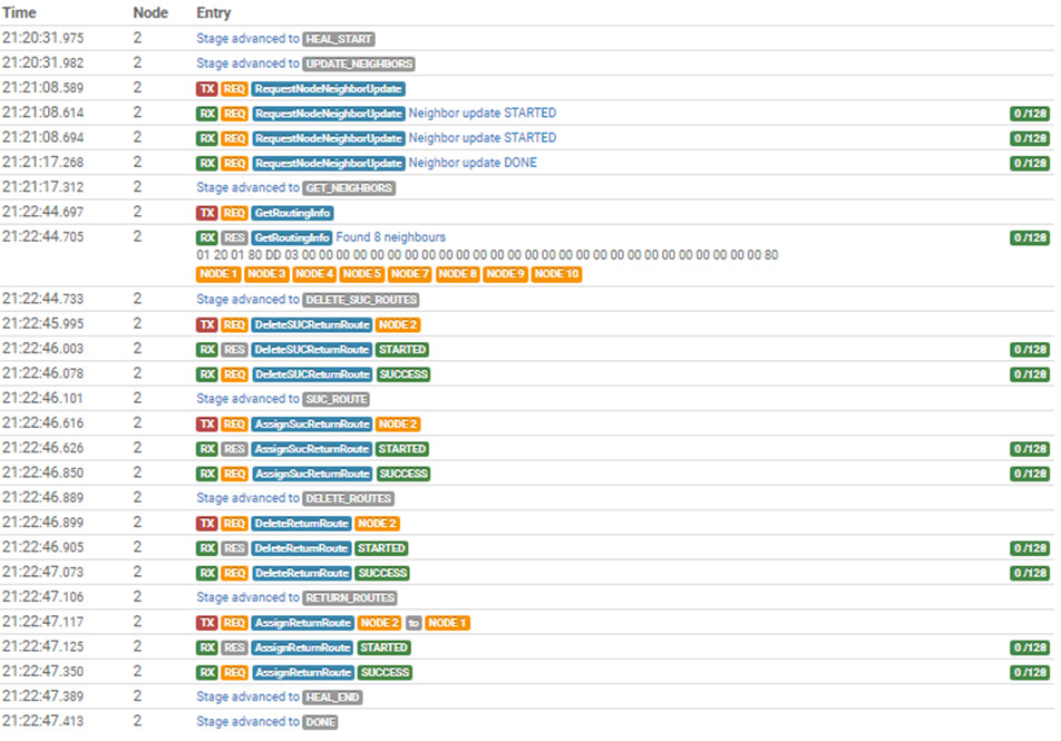

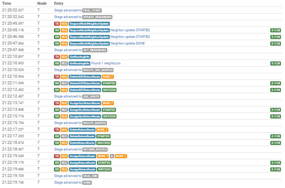

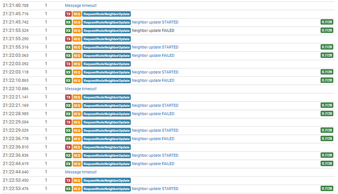

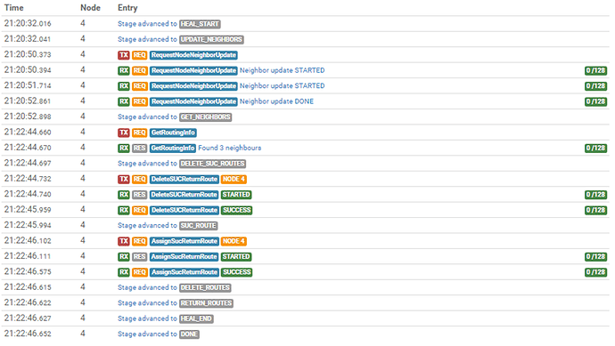

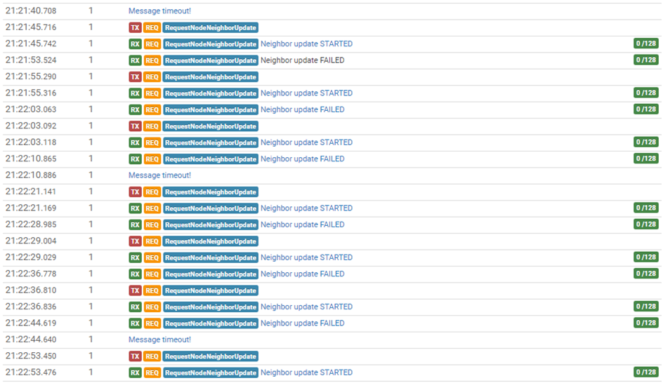

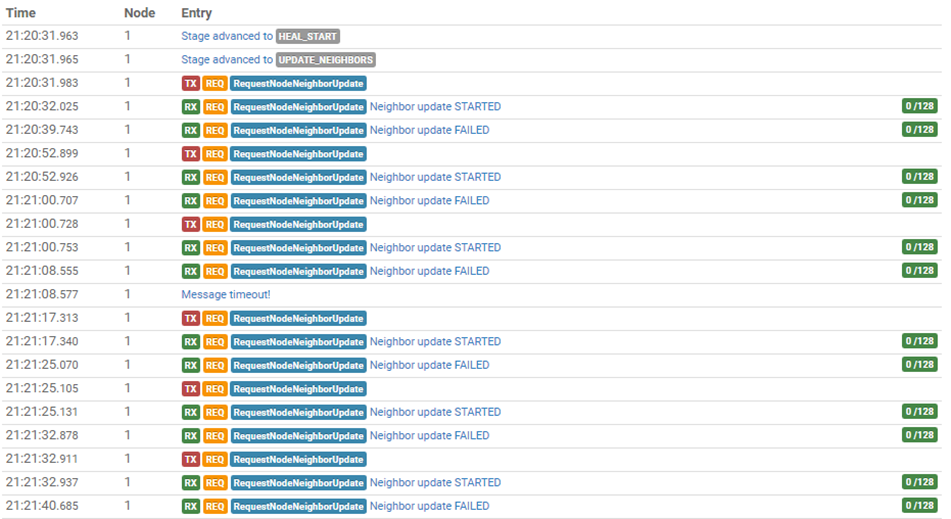

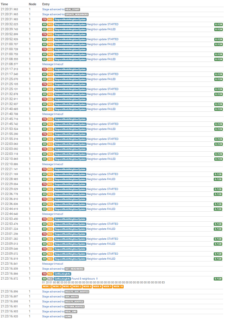

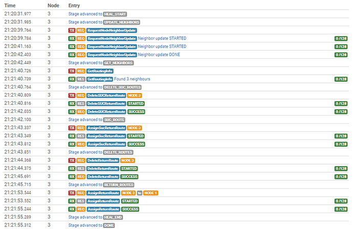

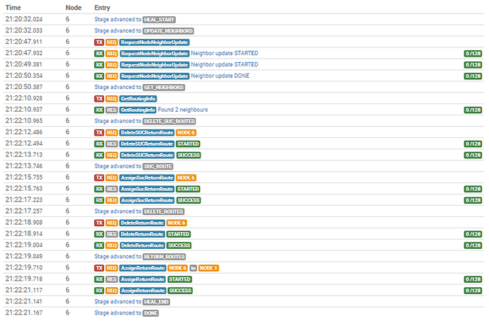

Here are my findings:
NETWORK HEAL

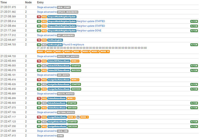

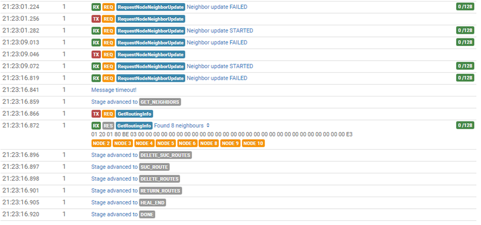

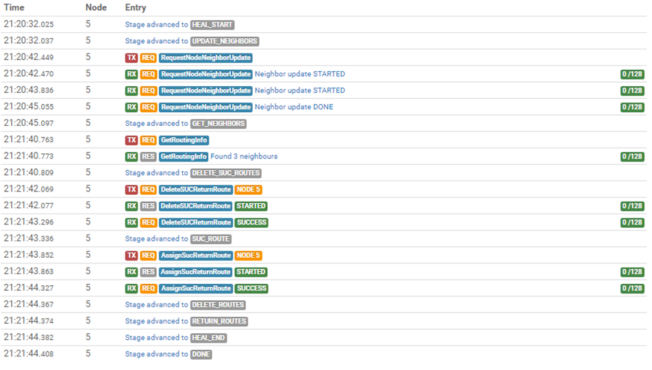

node1:
For a better resolution, see here.
node2:
node3:
node4:
node5:

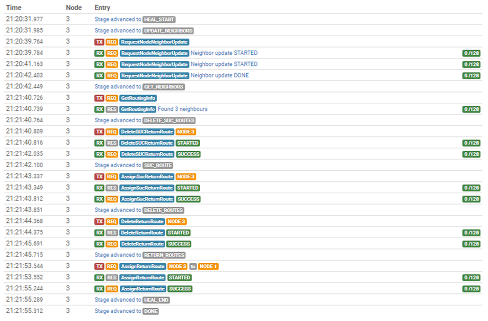

node6:
node7:

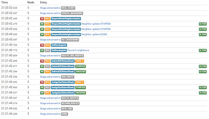

As you can see all FLiRS (node3, node4, node5, node6, node7) were healed! OK!

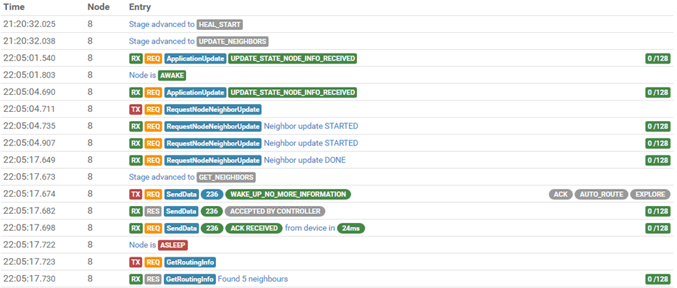

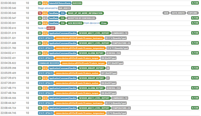

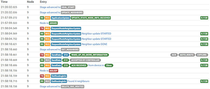

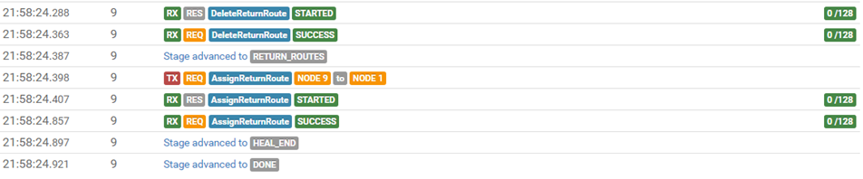

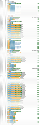

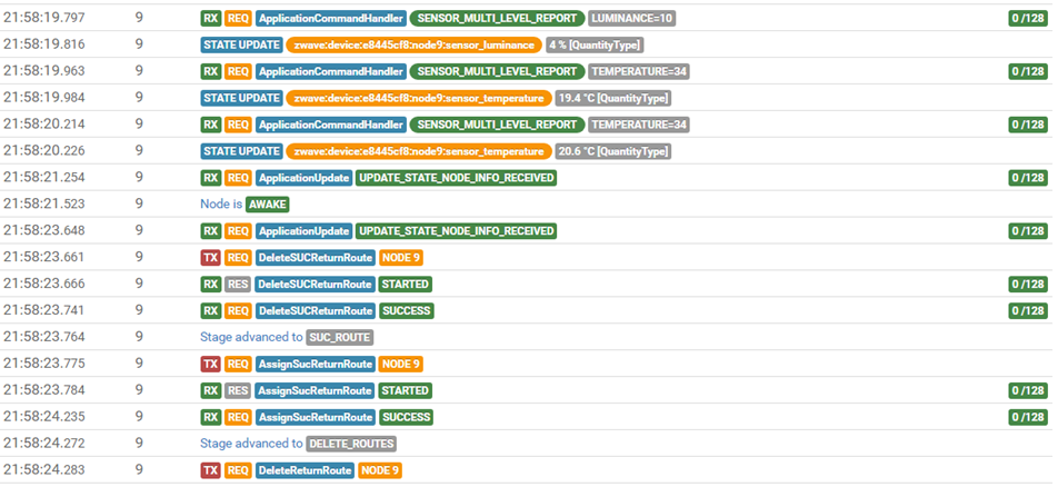

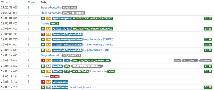

Now the interesting part: all “non listening nodes” (node8, node9, node10)
node8:
node9:

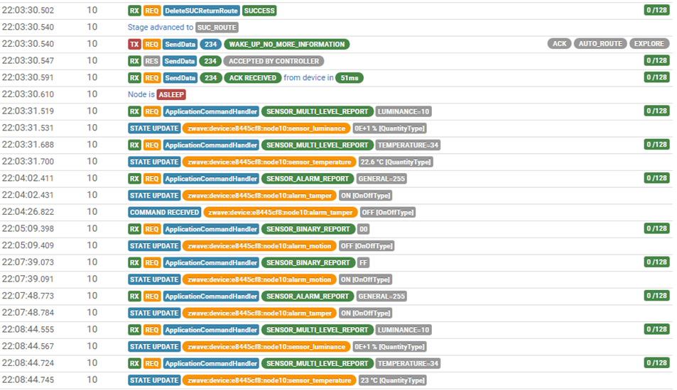

node10:

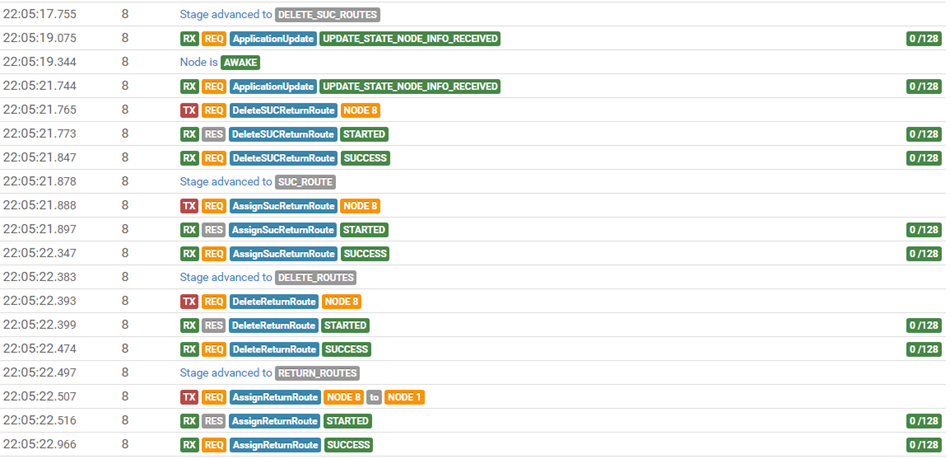

As you can see, they were not healed automatically.
I had to wake them up manually.

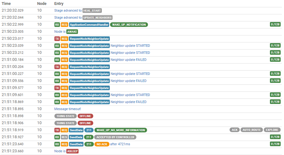

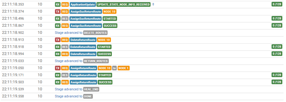

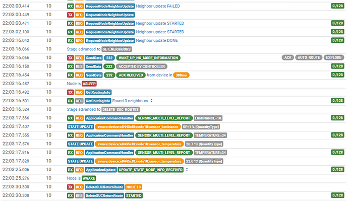

node10: There you can see, it first woke up on its own, healing FAILED.
Later I manually woke it up, then it was healed.

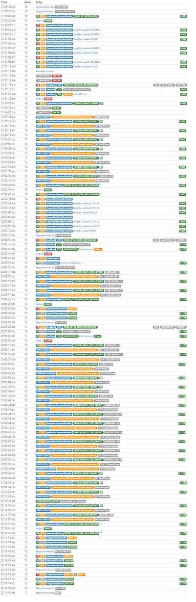

Here is the complete DEBUG.log : DEBUG.log (654.2 KB)
So you can load and filter it on your own, here:
https://www.cd-jackson.com/index.php/openhab/zwave-log-viewer
PS: ALL images were readable (big enough) at my PC, but they were zipped during upload, SORRY!
Explanation:
healing started at 21:20, controller tried 5 times with 3 requests. They all FAILED. The 6th try was successful then. The node1, node2, node3, node4, node5, node6, node7 were healed until 21:23.
Node8, node9, node10 were not healed within the next 30 minutes. Then (21:50) node 10 woke up on its own (=wake up interval), but healing FAILED and it was getting OFFLINE.
After this event, I woke up all three left nodes (8, 9, 10) manually and they were healed.
node9: start: 21:57 ; end: 21:58
node8: start: 22:05 ; end: 22:05

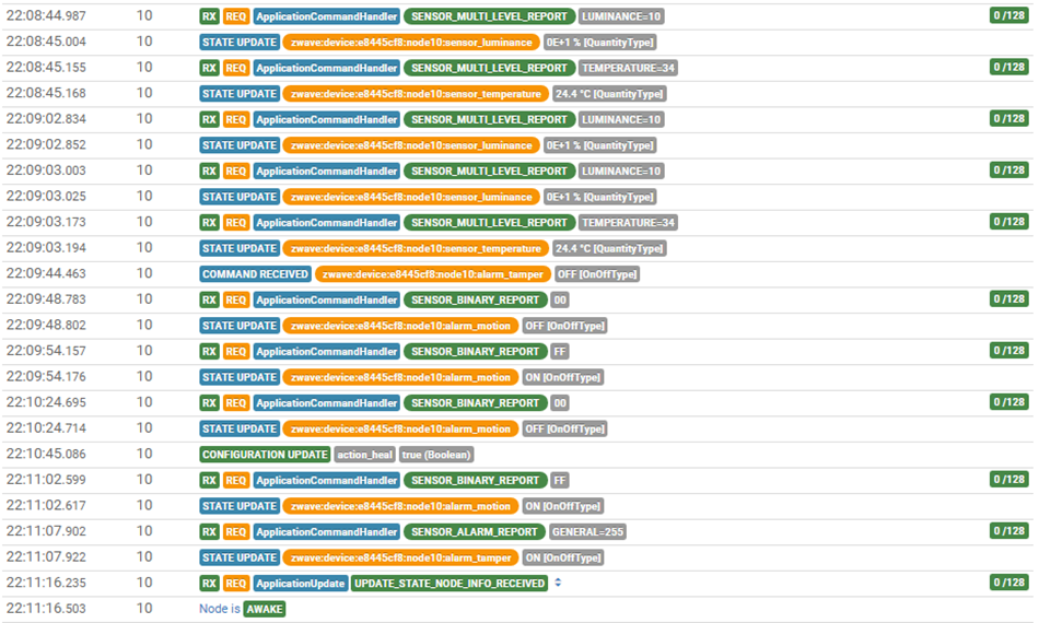

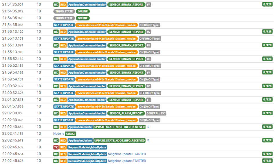

node10: I woke it up 2x at 22:02 and 22:11 ((in the meantime a lot of motion/tamper were detected, because I was in front of the sensor or I moved it a little bit, to press the button!))
node10: start: 22:02; end: 22:11

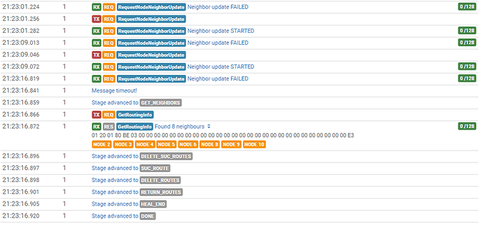

node1: (better resolution)
node10: (better resolution)
