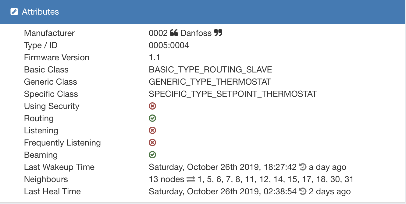

@ariela
Do you have “battery powered” and “non listening” nodes? You can see it in HABmin, select a node → properties (down to the bottom), where could see: last heal, routing, beaming, frequently listening, listening, last wake up, neighbors. If your nodes are neither “frequently listening” nor “listening” then you could have also this issue.

I have 5 Danfoss Thermostat valves
 battery powered, not listening and even not frequent listening. But those valves are working correctly, I mean no errors/issues in my logs. Last heal is always as expected

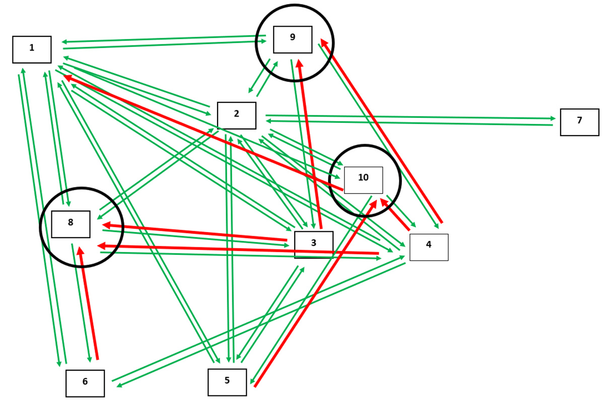

Here is my neighbor map, according to last heal (see above):
It is very strange!
node1=controller, node2=repeater
node3 und node7 are downstairs.
GREEN = sees neighbor
RED = DOES NOT see neighbor
node 8,9,10 are the “problem nodes”!
