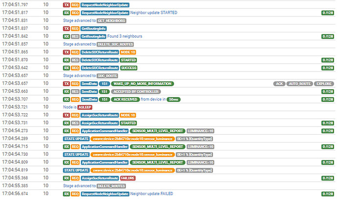

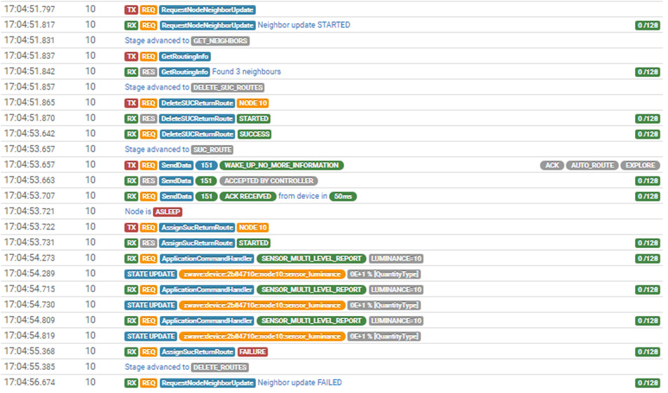

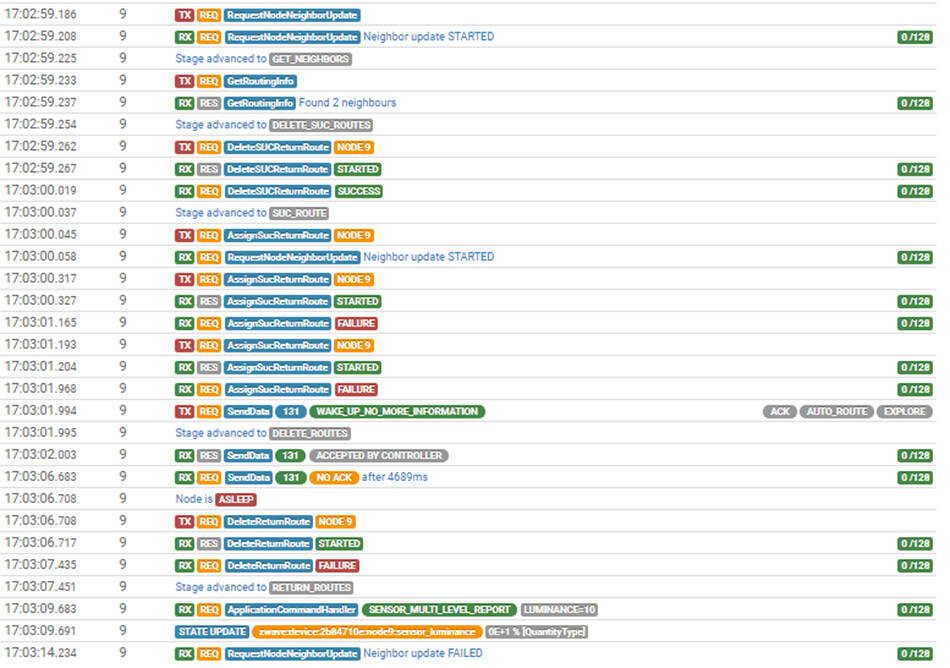

I now have deleted all zwave things (via PaperUI), also the controller thing, and have added these again using a new ThingID. Same result. Healing of nodes 8, 9, 10 ("non listening nodes) FAILED. The result is even worse. No manual healing is possible anymore. I could post the DEBUG.log here if anyone cares. If not, no matter.

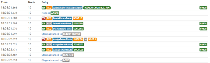

Set to heal in HABmin, wake up node manually.

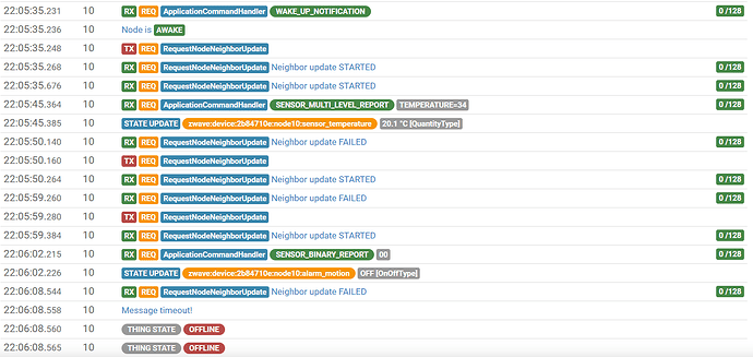

node10:
But this morning I was able to heal node9. But I have no DEBUG.log
The other ones (node8 and node10) I didn’t test, because I need a ladder to wake them up…

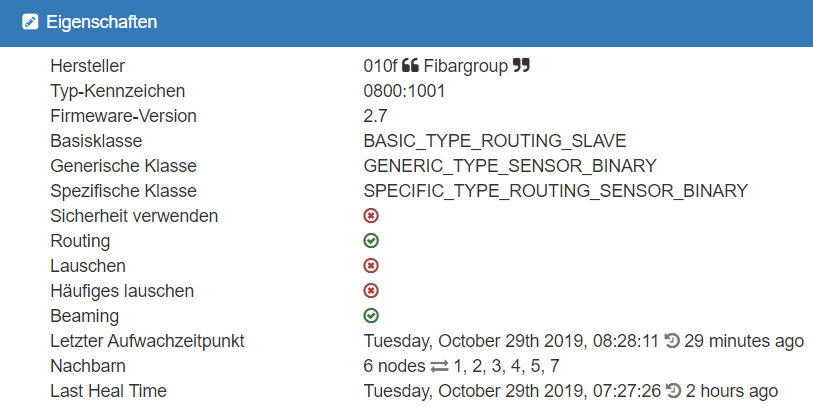

Btw, I found out the following:
If a device is initialised, then you can see the following in ā€œAdvanced Settingsā€:
Then you are able to ā€œReinitialise the deviceā€.
If a device is not initialised, then you can see the following in ā€œAdvanced Settingsā€:
All my devices were ā€œinitialisedā€ before I tried a heal.
It’s hard to say what’s going on with node 10. If I understand correctly, the heal fails when the device wakes up on its own, but succeeds when you wake the device up manually. My only thought is that the device stays awake longer when manually woken up versus when it wakes up on it’s own. That would be a question for the manufacturer of the device.
I don’t think so, that the awake period is longer, but you could wake it up very often in a row (by pressing many times the button).

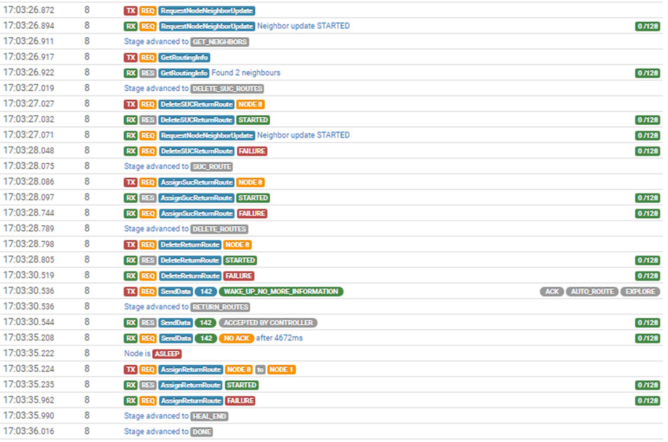

Here are the results of my testing:
Today I’ve tested: Snapshot #1731, with a downgraded z-wave binding #1486:
 279 │ Active │  80 │ 2.5.0.201901020757    │ ZWave Binding

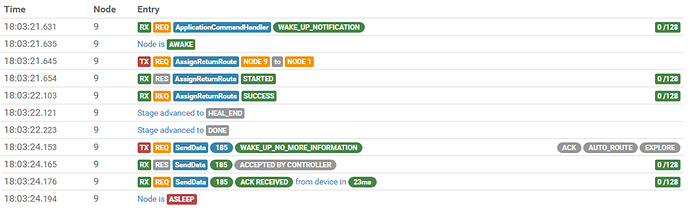

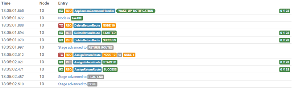

Heal was running completly for: node9, node10, but it took 2 wakeup intervals!
node9:
node10:

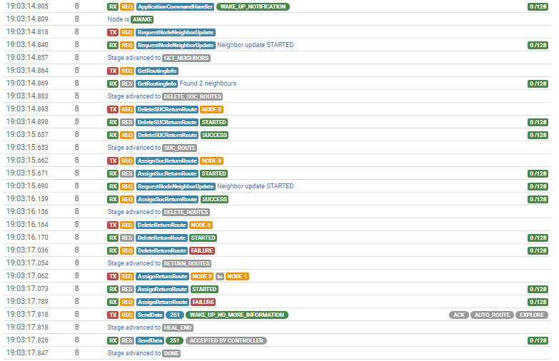

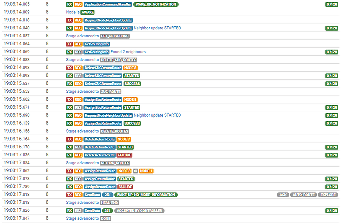

node8: It was a failure while ā€œassigning return routeā€, but heal was done.
I’ve triggered a further heal, this will be complete in about 15 min. I’ll report it…
node9 and node10 were healed again!
node8: same result, failure while ā€œassigning return routeā€, but heal was done.
What does this mean?
