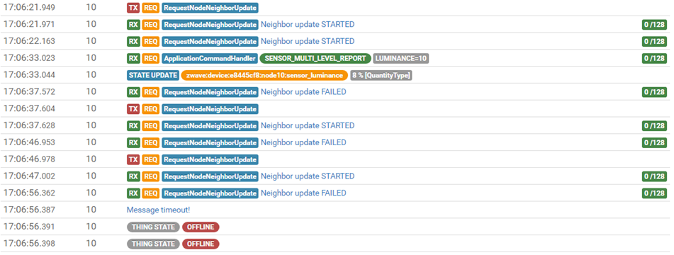

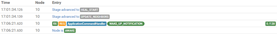

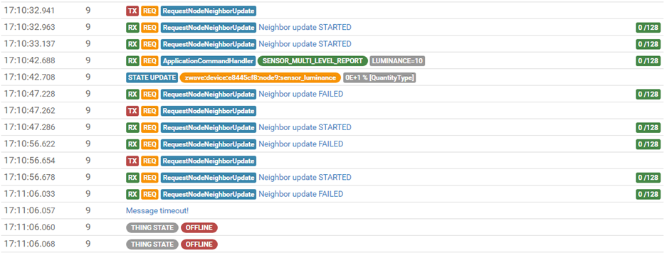

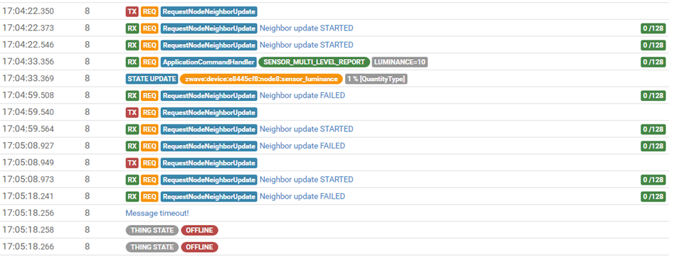

Hello folks,
today I’ve tested the other way around: Snapshot 1486 with “Z-Wave Binding 1731” only.
Here are the results: automatic network heal does NOT work.

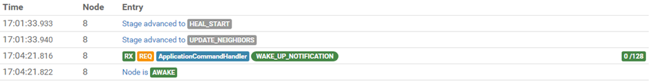

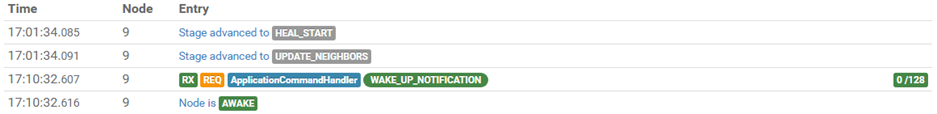

node8:
node9:
node10:
SUMMARY:
Network heal with Snapshot 1731 and z-wave binding (1731) is NOT RUNNING.
Network heal with Snapshot 1731 and downgraded z-wave binding (1486) is RUNNING.
Network heal with Snapshot 1486 and upgraded z-wave binding (1731) is NOT RUNNING.
Conclusion:
There seems to be a problem in the z-wave binding or database.
My 3 devices are all: Fibaro FGMS001, Firmware 2.7, Type: 0800:1001
Maybe that’s the problem?

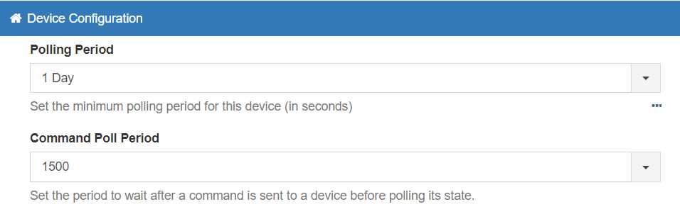

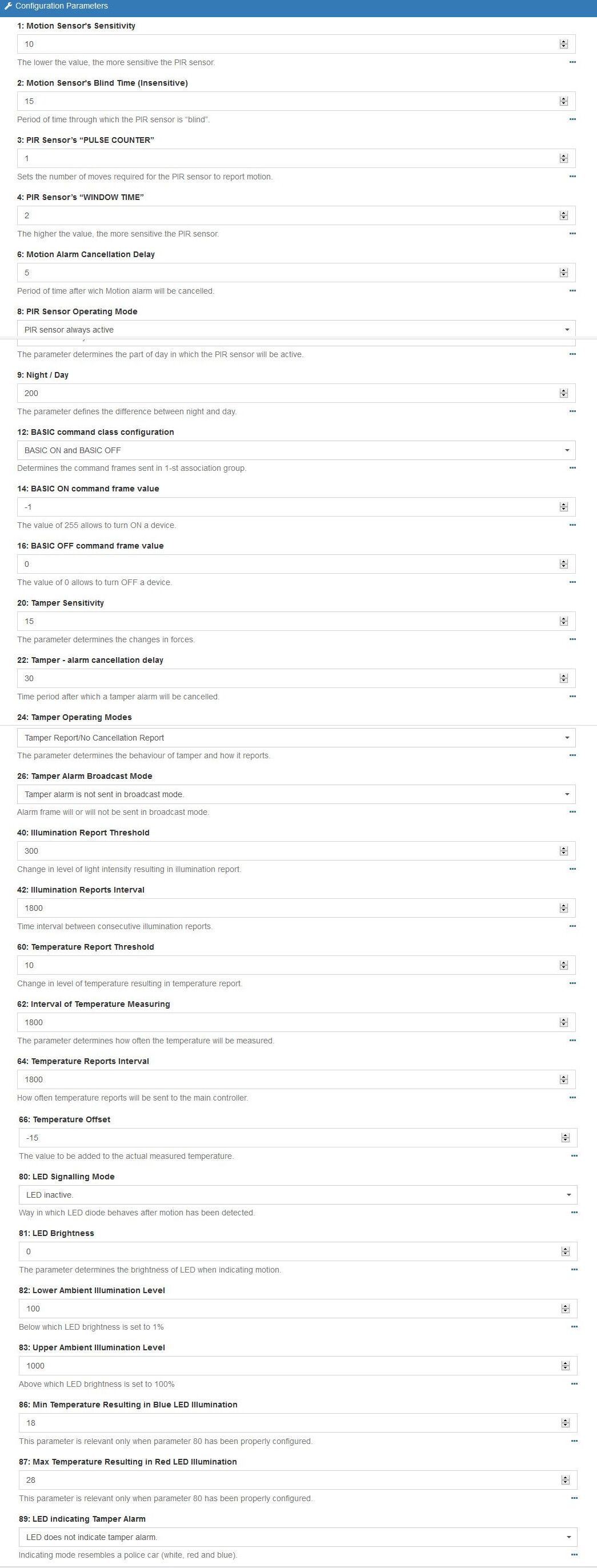

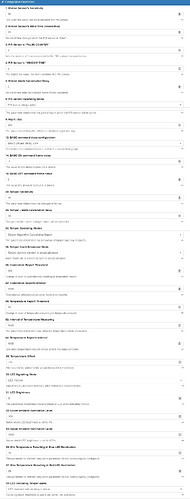

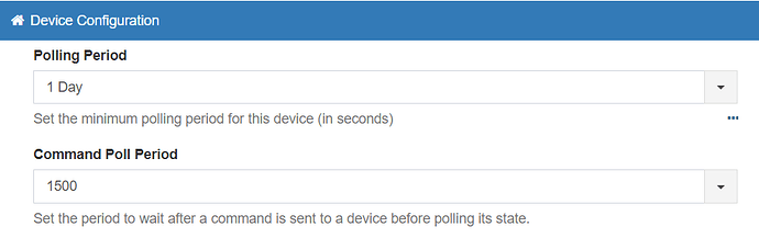

@sihui
I could see a difference:
You have set:
And I have, by default: (I didn’t change anything!)
Was this recommended somewhere?
And what did you set here?
For every zwave device you need to set the Controller update association group to your controller stick to get updates for your values in openHAB.
For the Lifeline group this is done by the binding automatically. But not for older devices.
After you have changed the setting a pending mark appears in HABmin, you need to wake the device (fast triple click the button right next to the battery until the LED glows blue) until the pending mark disappears. You probably need to wake the device several times.
Associations are also used to send state updates to the controller when the state of a device changes. For example, if you turn a light on, the device will let the controller know so that the state of the light is shown correctly within the user interface.
