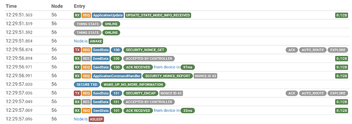

It’s a zip file but I had to rename it to upload it. I looked at it, but It all looks good and then it goes to sleep so I’ve no idea what I’m looking at. The problem device is node 56.

In the log there is just a single message from the device so there’s not really a lot to go on. Clearly the device CAN communicate, but maybe it doesn’t work well - I really don’t know as there is very little to go on.

No - I don’t think it’s defective, although I can’t be sure as I only have the limited data above to go on. This does however show that it’s transmitting, and it’s securely included which also looks like it’s probably ok. There’s no data sent though - just the NIF.

That’s what I see in the log. The device is waking up, but has no data to send so it goes back to sleep.

To be honest, I’m not exactly sure what problem you are reporting? I guess that the device is not sending reports for motion (this is a motion sensor?), but you don’t say. All that you’ve said is that nothing happens when you wake it up, but from the very short log, that’s not correct - when you wake up the device, it sends a wakeup, and the binding receives and responds appropriately. This all looks normal.
I guess you have another problem - maybe the device is not configured properly - maybe the associations aren’t set (these should be set during the initialisation phase) - I’m not really sure. I would suggest to do what Bruce suggested - exclude it, reset it, and reinitialise it - but please capture a full debug log of the process so that we can see what is happening. Otherwise we’re just running in the dark (which is why we keep bashing into walls :slight_smile: ).
