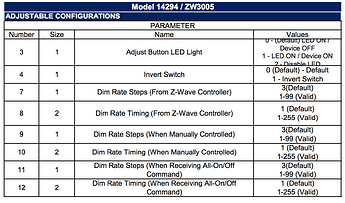

Updating also worked for me to get the dimmers recognized. However, I think they have some dimmer config that is missing. I think this is a direct match:
http://www.ezzwave.com/sites/jasco/uploads/documents/PDFs/part2/14294_Product_Page.pdf
At the very bottom of the pdf:
Does that make sense? Should I submit a ticket to edit the DB?
Edit: Just realized this post is for ZW3004. I guess I’m hijacking a little then with ZW3005 although it seems the only difference is that 5 is paddle and 4 is toggle.
