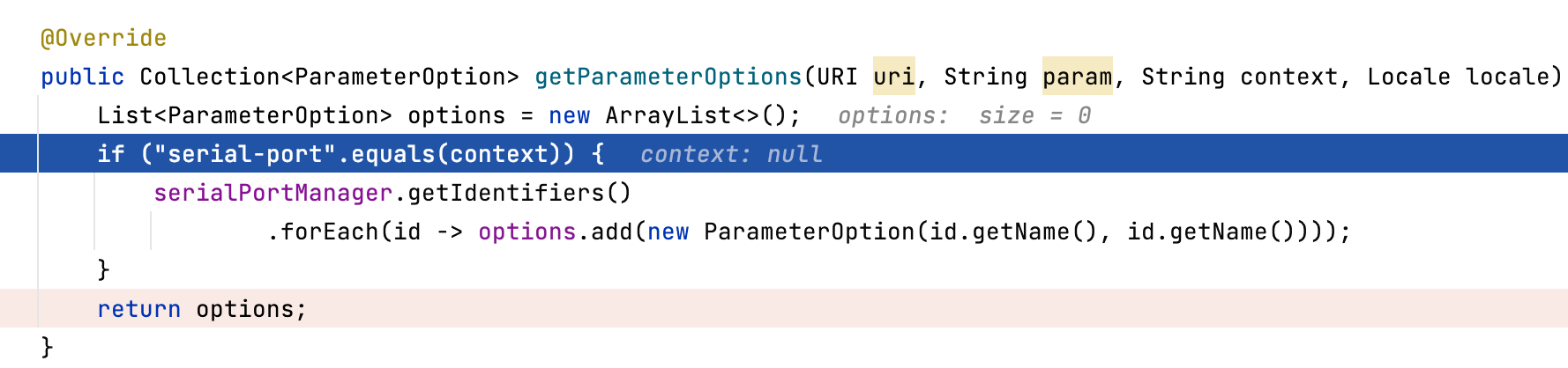

However when I am in SerialConfigOptionProvider() and the uri=“thing-type:jeelink:lgwUsb” and the context = “serial-port”
it only returns
ParameterOption [value=“/dev/ttyAMA0”, label=“/dev/ttyAMA0”]
Note that the following method does have all different ports available as provided via startup
The problem I see is as follows: The following method has all the defined serial ports
doesn’t return all five. So, what does the ComportIdentifier.getPortIdentifiers() has todo with the content of the variable “value”?
Even in that class there is only one comport:
and I have no clue, why?
