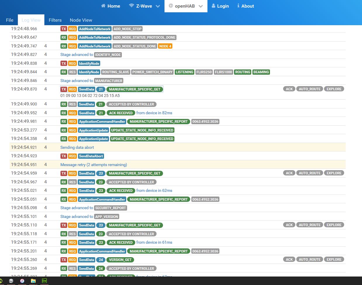

I"m struggling to understand why two of my Zwave devices are unable to resolve. I paired two brand new GE 14291 (SW4005) switches with my OpenHab 2.0 running on a Raspberry PI 3.0 with the razberry z-wave card. I have several Leviton zwave devices that are working correctly installed on this system but have hit a roadblock with these GE devices. I get the following error:

I checked the Z wave Product database at http://www.cd-jackson.com, and there is an existing entry in the
openHAB-2 product file for Jasco Products GE 14291 (ZW4005) in the database. I checked out the zwave log viewer, and communication with the Node 4 switch appears to be flowing.

Manufacture and product ID seem to match, so I am at a loss on where to look next to figure out why the existing product can not be found. I’ve scoured the logs and the forums. I found the basic zwave troubleshooting documentation here (Z Wave Product Database · openhab/org.openhab.ui.habmin Wiki · GitHub) but have not found any documentation on troubleshooting why an existing product does not register.
I was expecting to see a wrong value between the node XML and the product file, but with appropriate conversion from HEX values values seem to be correct and consistent. I double checked and updated System and Openhab modules to ensure I had the latest updates.
