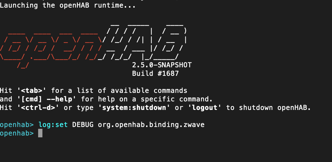

Do I need to run the terminal command: [ log:set DEBUG org.openhab.binding.zwave ] within a specific folder?

You need to run it from the openHAB console.

Like this?
13
Yes.
Cool.

2019-09-14 19:26:07.654 [DEBUG] [nal.protocol.ZWaveTransactionManager] - NODE 255: notifyTransactionResponse TID:183 CANCELLED
2019-09-14 19:26:07.655 [DEBUG] [nal.protocol.ZWaveTransactionManager] - Transaction SendNextMessage 0 out at start. Holdoff false.
This didn’t find any new devices - I’m assuming you are also putting the device into inclusion mode?
What is node 3, and what device are you trying to include?
