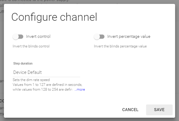

I try to change my Things in inverted mode.
If I do in PaperUi ok but I want to do in things files.
I find post but for me it’s does not work
Where is my mistake ?
Thx

Ok I found !
It’s
Type blinds_control : blinds_control [ config_invert_percent=true ]
Without " "
