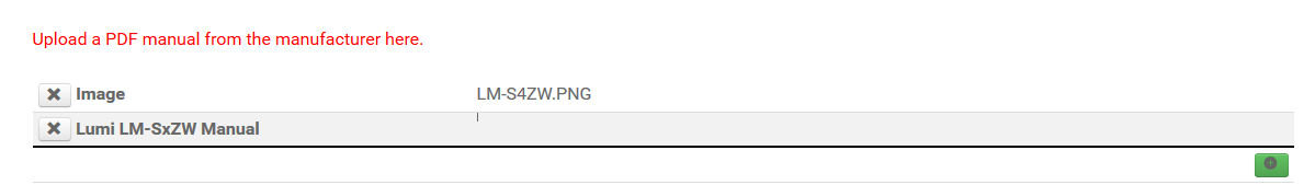

Something went wrong, there is no manual:
Thanks for noticing.
I uploaded again and now it’s showing.
The seller just sent me the official manual in English. So I uploaded that too.
