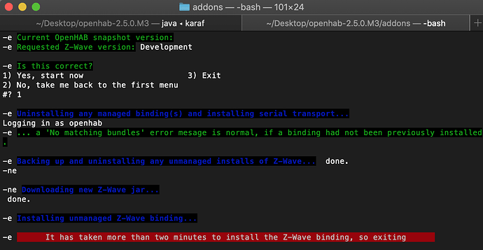

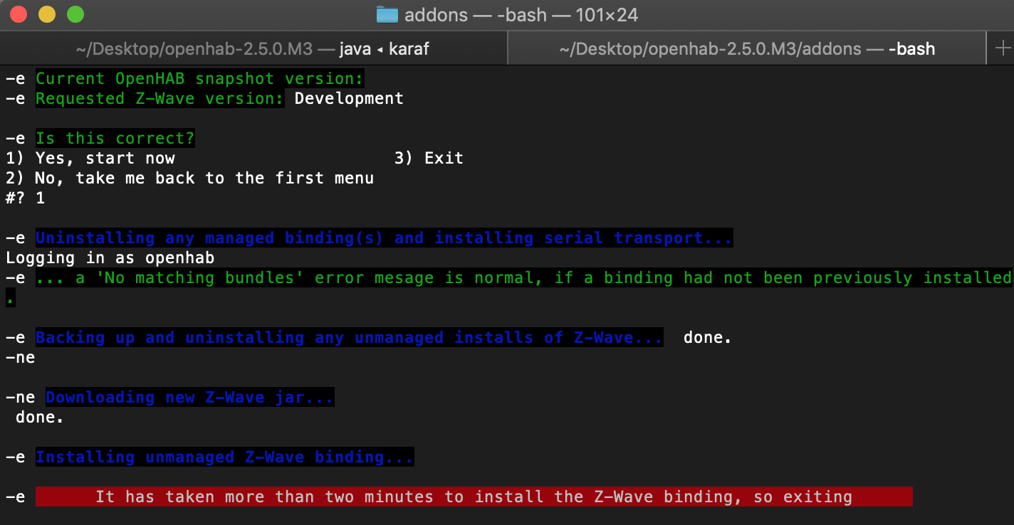

I tried to update the ZWave binding to the snapshot (and also the development) version using the script, but I’m getting an error message that the binding’s installation timed out.
Any ideas why?
@5iver @chris @Bruce_Osborne @sihui
Try the manual installation steps or do everything manually and download the jar here:
https://openhab.jfrog.io/openhab/online-repo-snapshot/2.5/org/openhab/addons/bundles/org.openhab.binding.zwave/2.5.0-SNAPSHOT/
