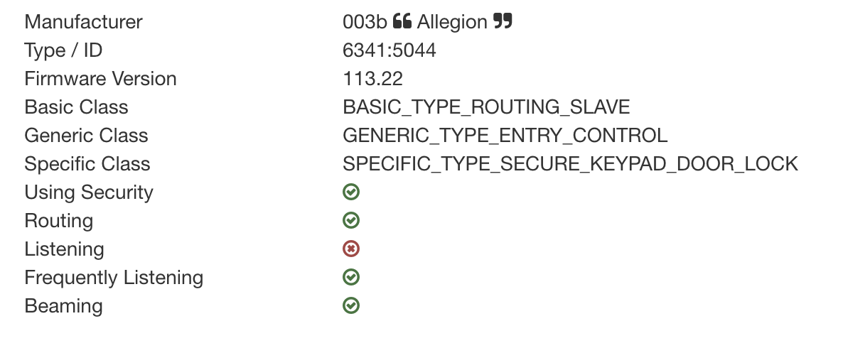

Here is the settings for the lock in Habmin:
05%20PM

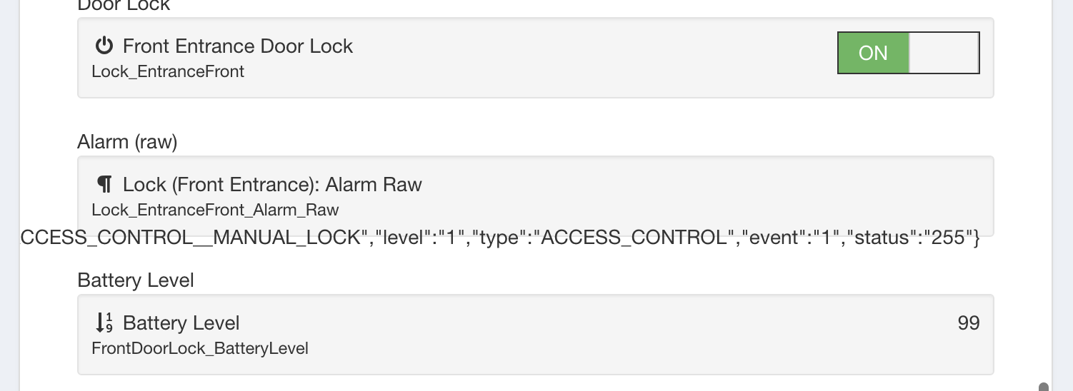

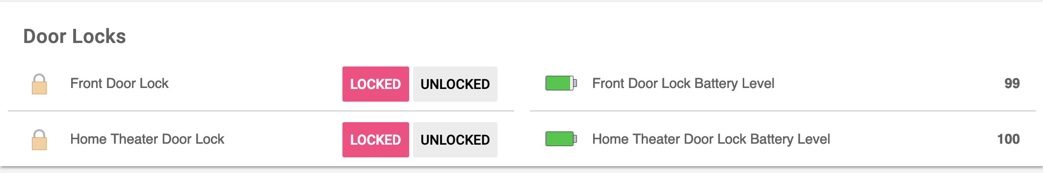

Here it is in BasicUI:
31%20PM

I see the alarm_raw value in habamin
40%20PM
