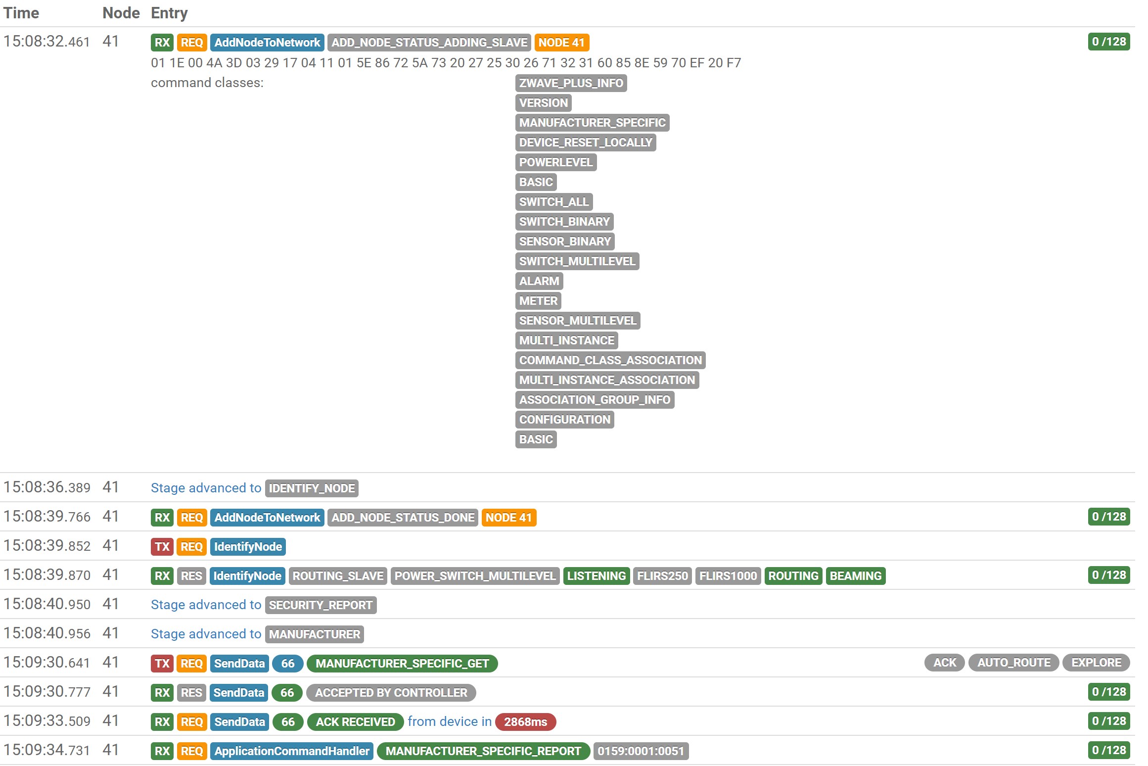

I cannot do a secure inclusion of my Qubino Flush Dimmer device (ZMNHDD). The Qubino Flush Dimmer device is included ‘non secure’. I.e. the inclusion is successful but security is not used.
To my understanding, on the device the steps are the same for ‘secure inclusion’ and ‘non secure inclusion’. It is up to the “gateway (hub)” to do secure inclusion or not.
The attached log shows that there is no SECURITY command class in AddNodeToNetwork ADD_NODE_STATUS_ADDING_SLAVE (node 41). As consequence, the openhab zwave binding does not perform secure inclusion.
zmnhdd_not_secure_included.log (173.8 KB)
