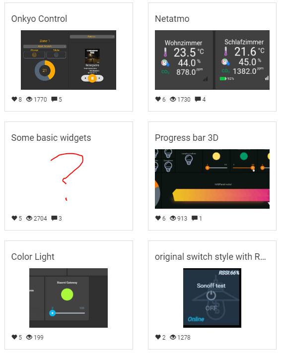

@olir could you add some screenshots to your original post so it appears nicely in the new widget gallery?
