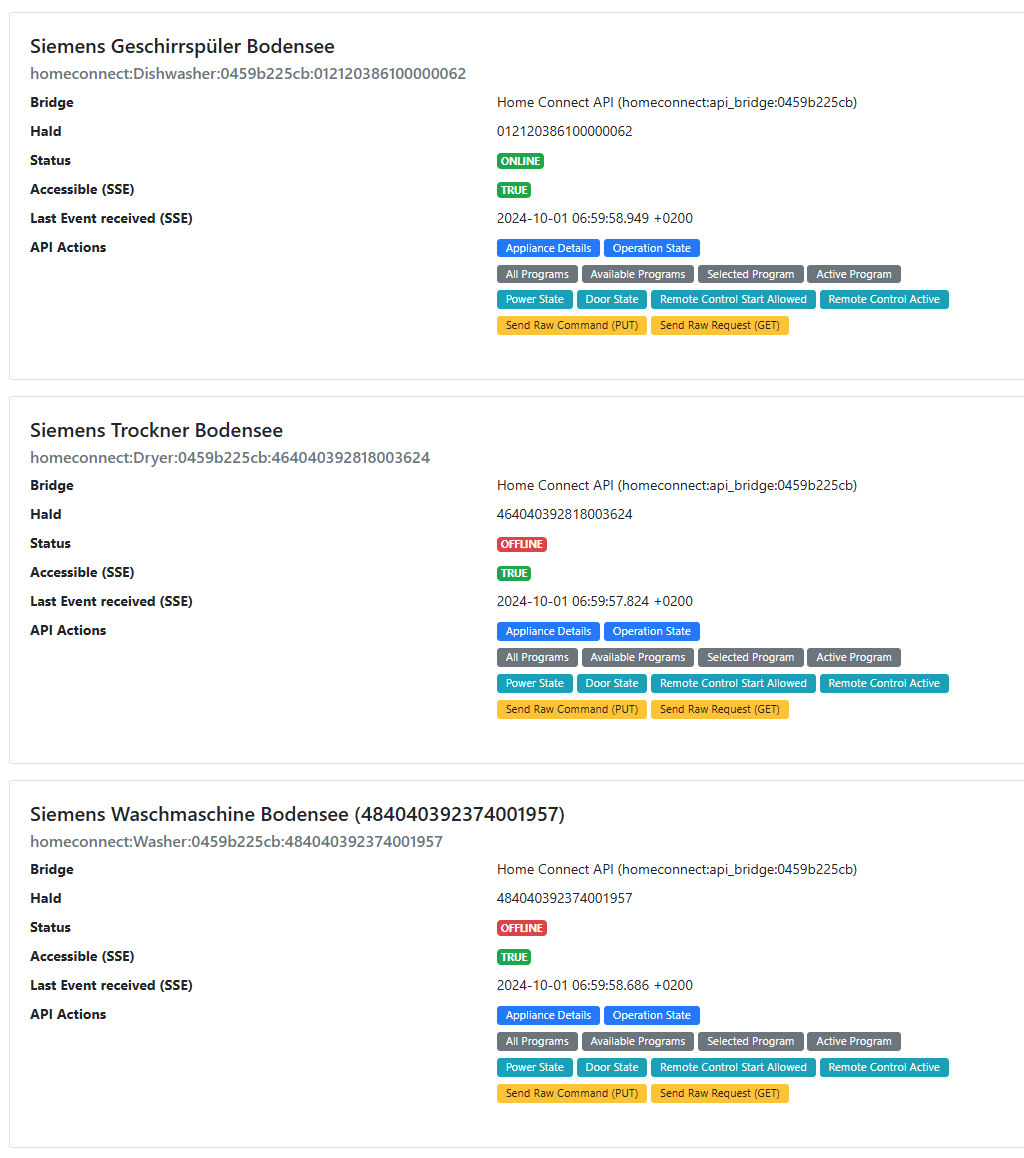

http://192.168.178.80:8080/homeconnect
(Adjust the op to match your setup)
This page should give you all information needed about authorisation, connection and received data. Anything noticeable there?

@lsiepel I’ve been to this page before which is where I got my initial message from. I can see all three devices there with one being alive and active and the other two always appearing as offline.
The bridge is sending requests every 30 minutes to both washing machine and dryer any always receives an offline message. The dishwasher is not receiving such a request.
In the Events section, there is a KEEP_ALIVE event for every device every minute.
So to me all looks good, except for the fact, that washing machine and dryer do not show up as online.

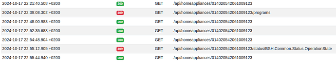

I am probably facing the same issue with a new setup.
With the HomeConnect app everything works fine.
In openhab, the bridge is online and was able to detect the dishwasher.
The Appliance data of my dishwasher successfully reads
"data": {
	"brand": "Bosch",
	"connected": false,
	"enumber": "SBV6ZCX16E/44",
	"haId": "014020542061009123",
	"name": "Geschirrspüler",
	"type": "Dishwasher",
	"vib": "SBV6ZCX16E"
But the dishwasher is always offline in openhab.
The API Requests show error 409 when functions of the dishwasher are requested:
whereas the error message says
  "error": {
    "description": "HomeAppliance is offline",
    "key": "SDK.Error.HomeAppliance.Connection.Initialization.Failed"
Regards,
Martin
