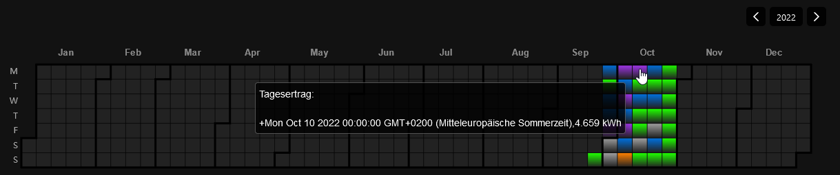

Hello, i’m experimenting with a calendar widget at the moment and i have a few questions:
To explain it more easy i made this screenshot and i’m refering to the colors
- red: It seems all changes to dayLabel are not being intrepreted while monthLabel and yearLabel are actually doing fine.
dayLabel:
show: false
Am i doing something wrong, is it a bug that appeared in some of oh’s newer versions or is it simply not implemented yet?

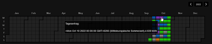

- green: formatting the monthLabel works nicely and all changes are interpreted. I’d like to change the nameMap from EN to DE. the echarts docs say that it’s using the locale of the system, however when i change to “DE” for example values are not being displayed anymore. “CN” works fine. Is it possible to somehow include DE?
Example:
monthLabel:
nameMap: CN
monthLabel:
nameMap: DE
renders like this:

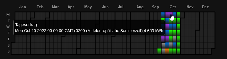

- Formatter of the Labels.
tooltip:
- component: oh-chart-tooltip
formatter: "{a}:<br>{b}{c} kWh"
In the following scenario the br between {b} and {c} actually shows even before {a}. The + makes it visible.
formatter: "{a}:<br>{b}<br>+{c} kWh"
Does someone have a proper example on how to do this right? Also an example of valueFormatter would really help.
