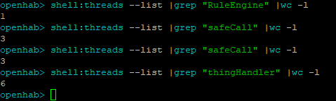

Is that screenshot taken while everything is working or while the rules have stopped working?
