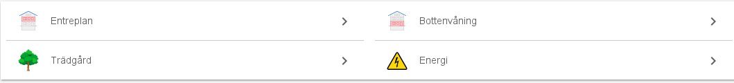

With basic ui, I get the initial sitemap, but cannot click further on some groups;

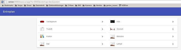

Here ‘Entreplan’ works as it should but not ‘Bottenvåning’. i.e. if I click ‘Entreplan’ it will give me;
In Chromium, If I click ‘Bottenvåning’, nothing happens.
However, if I instead enter the path in the browser (e.g. http://xenon:8080/basicui/app?w=0001&sitemap=beckasinen ) it works (i arrive to ‘Bottenvåning’)! In Firefox, I get the URL in the edit box, when pressing, ‘Bottenvåning’, and if I then press reload, I get the proper content. Also if I just press enter in the URL edit field on Firefox.
